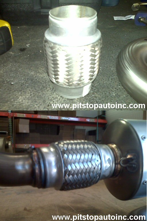

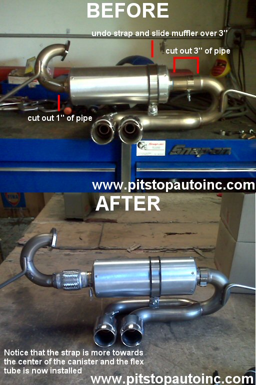

Hello everyone. Well for those of you who have put an aftermarket exhaust on your smart, you'll notice like I did that it cracks because if you remember on your factory exhaust that on the left hand there is flex tube. The steel braided stuff. That is there to absorbe all of the vibration that your engine makes because your exhaust is mounted to the car pretty rigidly. So then thinking back to the aftermarket exhaust you'll notice that on a lot of the cheaper brands that this tube is now solid. Some of the high end exhaust from smartmaddness have flex, but I personally don't wanna pay 600-800 bones for one =) My exhaust completely and I mean completely fell apart. So did another one of our club members in IE SMARTIES!! So I got to thinking, and did a little research, and found a small flex tube from a company back east. Every exhaust shop that I called around our area in so. cal wanted about 50-60 for this damn thing, and I thought that was nuts. From this company INCLUDING SHIPPING I pad a little over $13.00 from a company called Exhaust Depot. Now they don't answer their phone at all but they do answer emails really fast. They drop shipped it for me from whoever they get it from in Florida and I had it in about a week. Just so you know, you need to order a 4" long flex that has either a 1 5/8" ID or 1 3/4" ID. Exhaust depot only had 1 3/4" so that is what I bought and swaged the tube to make it larger. Here is the info of the place to buy the flex tube, and here is the info of a freaking GREAT! exhaust shop that tig welded all the stainless for me. I owe a lot to these guys, they are just freaking cool!!!!

Thanks for the info; what did the whole thing (including the cutting/welding) run you if you don't mind telling us?

Well it was $13.00 for the flex tube and for bills to weld it, it was $60.00 however when I paid bills, I had him weld some other things for our store so I would imagine that he would probably charge around $40-$50.00 just for the exhaust. So in a nut shell I have about $60.00 wrapped into the whole mod.
