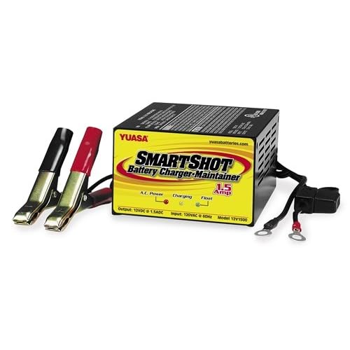

Having owned numerous battery float chargers, including the brand name Battery Tender, I can say without reservation, that I'd choose the Yuasa SmartShot any day:
It's simply a better battery maintainer, by far. It charges a low battery quicker. It maintains a charged battery better. It combats sulfation better. And this is coming from someone with three motorcycles and a boat.

As long as the battery is in good condition and fully topped up when you start, it should work okay.
The inexpensive float-only chargers (unlike multi-mode pulse chargers such as the Yuasa) can't really recharge a discharged battery, reverse sulfation, or do anything to revive weak batteries, but they are much better than letting your battery discharge continuously.
