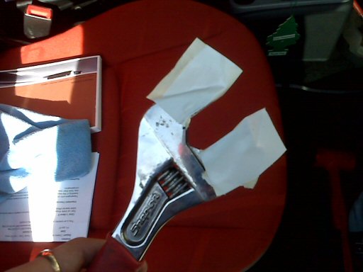

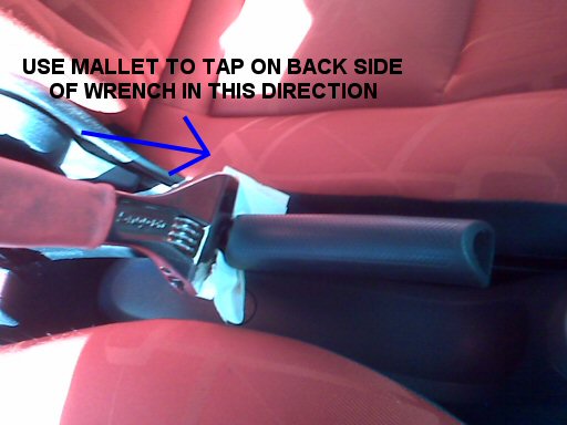

Thanked 5 Times in 4 Posts
Now I understand what jetful was talking about, a few simple taps and it slid right off, no cutting no damage. First you thread out the button with your fingers, then wrap a crecent wrench with some tape to keep it from scratching anything, then a few taps toward the front of the car and it slid right off. BTW my car was one of the later models that does not have the plastic set pin.
