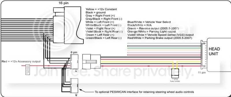

Hey guys I found this and it may be the correct color code for Smarts
