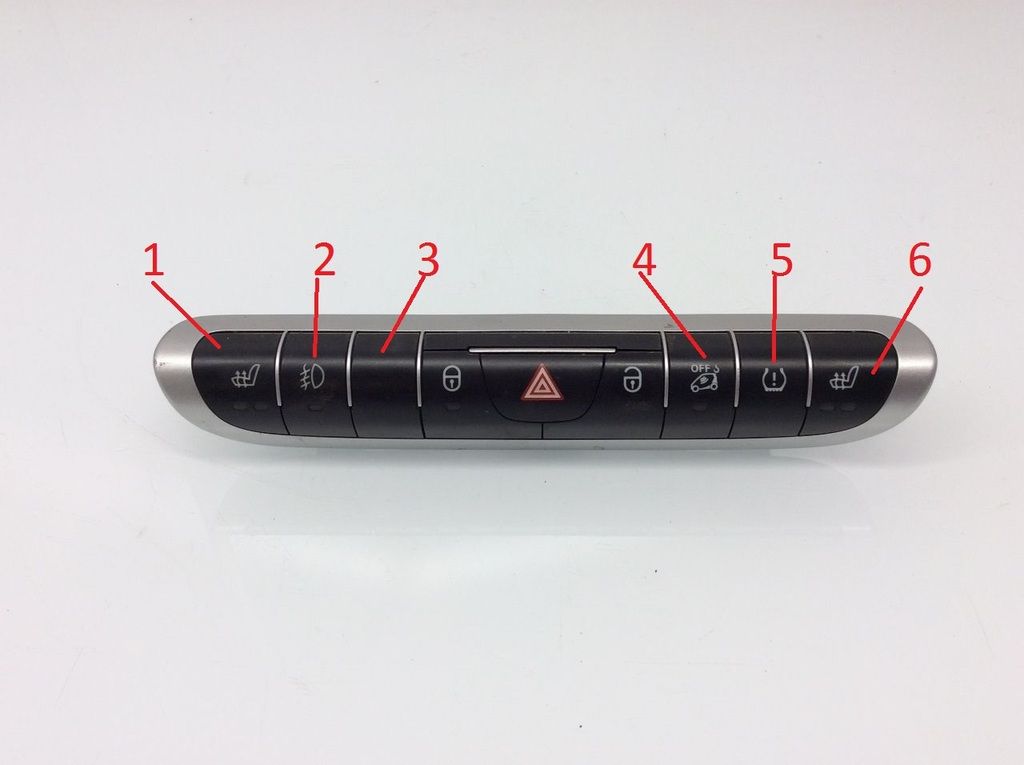

Have you ever wanted to use a spare switch in the button bank to power a 12 volt circuit? The switches in the button bank are intermittent and in order to avoid programming the SAM to convert a switch to a true on/off circuit all you have to do is patch in a latchable relay. See this link to ebay. Hot 12V 1 Channel Latching Relay Module with Touch Bistable Switch MCU Control | eBay The evilution site describes how to disassemble the button bank and provides a wiring diagram for the button bank. I used one of these relays to power a wind up key on my wife's Smart. Smart simply paints the button bank black, so using my Dremel I was able to scratch/slightly grind the paint off the switch to make the windup key icon. Now the factory LED light in he switch lights up the icon! Here's a link to my youtube video of the windup key. The video also shows the button bank in use.

That was a great job on the wind up key. It must have been really tedious to etch a key icon like that on a small bank button. You must have patients,steady hand, and artistic ability, I have none of that. But you really piqued my interest. Could you elaborate a little more on modifying the button bank? I like many other don't have a subscription to the wonderful Evilution site. Do you have to disconnect a pair of wires from the button bank connector to keep from tripping the SAM up? I'd like to do the garage door opener mod with the button bank and that could be momentary, so no need for a latching relay, but I do have a couple of other installed projects that I could lose the existing switch and route it through the button bank and a latching relay. DCO

There are tabs on the 4 corners of the button that keep it so you can't push it to activate the switch. remove the tabs and the button will work . as for the wiring, you can add a wire on the connector in the correct spot and you are good to go.
Remember, the buttons when pushed, provide a ground so you will most likely need a relay to convert to a power source. The switch won't take much current before melting so a relay is a good idea anyhow.

I first decided which button to use. Then disassemble the button bank and cut off the 4 tabs on the back of the button so you'll be able to make that button/switch useable. Then you need to determine which two wires in the wiring harness connect to that button/switch. That wiring diagram is also on the Evilution site. (Although it might be in other locations too. If it's not out there I can try and figure out how to post the diagram.) Cut the two wires that go to that button/switch. Put electricians tape on the two wires that go into the harness. This will insolate the circuit you're 'switching' so you don't have any conflicts with the SAM. Now, use the wiring diagram that comes with the latching relay and you'll have a properly working on/off switch! Now, etching the wind-up key icon wasn't that difficult, it just took some time. I searched the web for switch icons. I found one close to a wind up key and printed it out and just modified it a bit so it looked more like a wind-up key. I then taped my icon over the button/switch and poked the outline of the icon through the paper with a pin. I removed my paper template, then used my dremel with a very small burr cutter and used it to 'scratch' the paint off the face of the button. And yes, it does take a steady hand. :)

Thank you Limoak for posting this. I was afraid to do any button bank mods for fear of making problems for the SAM (didn't know if SAM monitored all the switches even though they all aren't used). When I do mods to my Smart I always try to keep as much hidden as possible so in that regard I have added 4 switches to my smart. One turns on my foglights that I added (rocker switch under the dash), one turns on my DRL's (rocker switch by turn signal lever), the other turns on my power inverter that runs my stereo system (toggle switch under the dash) and the last one came with my kit for my heated seats (knob switches on center console). The heated seat switch I can't mod out to the bank because it is a 5 position switch, but the others are a definite canidate to integrate into the bank.
Out of the six buttons that are a candidate for modding, everyone I guess has #5 used for the TMPS. So that leaves 5. I have never seen #3 used on any vehicle that I can find. 1,2,4,and 6 when used from the factory have an LED that lights when that particular function is used, so I don't know if that factor plays into our purpose of using the button for a different purpose. I realize we take the button out of the circuit when we cut the wires to the harness, but if there are a function LED connected to the unused buttons that might affect the use of the button for other purposes. I will have to disassemble mine and see. If each micro switch in each button is indeed just a momentary switch then the Sam must do the actual switching for that circuit. I say that because the heated seats have high and low, so a momentary push would
select high and another momentary push would select low with the SAM doing the actual switching. DCO

DreamCarOwner- I don't know, even if a particular switch is not used, if the SAM 'monitors' that unused switch/circuit or not, but by cutting the wires that go to the SAM from that unused switch/circuit, the switch is obviously disconnected from the SAM. (Better safe than sorry, right?) I think the LED's that are in the switches come on when the car ignition is on. You simply don't see the light from the LED cause Smart painted the surface of the switch black. So, it was a pleasant surprise to me that the switch LED shows through! (Now I might be wrong on this, so if you find that having power go through the particular switch/circuit powers the switch LED, instead of the car ignition, please post your findings. (Either way, the LED should light.) Each switch in the button bank is a momentary switch and yes, from what I understand, the SAM does the actual switching for each circuit. That's why you have to add a latchable relay into each circuit. (And as others have stated, the switch can't take a lot of amps either.) One more note- Before I stuffed/zip tied the latchable relay under my dashboard, I put hot glue over the back of the printed circuit board of the relay to eliminate the chance that the back of the relay would come into contact with any metal and ground it out. Thought you'd like to see a close up picture of my button bank. Post any questions if you need help.

Nice job! I activated my fog lights on this button (the standard button for factory fogs). I drilled a hole for the green "ON" indicator to show through, and then filled in this new hole with clear hot-glue. I have not attempted to etch an icon on the button for fear of messing it up. Thanks for the tips. How deep did you need to grind into the button to remove the black coating?
One note of caution re this button bank. This type of contact uses a conductive coating on a flexible membrane to bridge the switch contacts on the circuit board - the same design as your common TV remote control. These switches are not designed to take much current, likely in the microamp to several milliamps tops. A relay generates an inductive kick from the coil when deactivated, which will erode this conductive coating. A diode across the coil will reduce the magnitude of this kick, but is still much more than the switch is designed for. I'd suggest using a transistor or other device to activate your relay.

For all of you that are following this Post, here's the Pin numbers of what I consider the available button bank switches. Note- I don't know what the corresponding Pin numbers are for Switches #1 & #6 . Besides, those two switches are used for the heated seats, which seems to be a commonly added factory option. Also, since Switch #1 & #6 (or at least the SAM ciruits) are two position switches/circuits, (1 for low heat, 1 for high heat), I wouldn't recommend using Switch #1 or #6 . Please refer to Posting #5 for an illustration of the below list of available Switch numbers:
Switch #2- Pin #3 is ground. Pin # 8 is 'hot' or 'positive'.
Switch #3 - Pin #3 is ground. Pin # 9 is 'hot' or 'positive'.
Switch #4- Pin #3 is ground. Pin # 13 is 'hot' or 'positive'.
Switch #5 - Pin #3 is ground. Pin # 14 is 'hot' or 'positive'.
