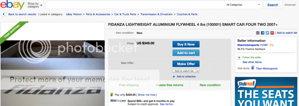

Found it on ebay:
Fidanza Lightweight Aluminium Flywheel 4 lbs 100001 Smart Car Four Two 2007 | eBay
ITEM DESCRIPTION:
FIDANZA'S aluminum flywheels are made from the highest quality 6061 T6 aluminum. The material is fantastic for strength, heat dissipation and of course reduction in weight.
BODY - 6061 T6 ALUMINUM Tolerances machined to +/- .001 6061 T6 has an ultimate tensile strength of at least 42,000 psi and a yield strength of at least 35,000 psi.
RING GEAR - 1050 STEEL / HEAT TREATED Heat treated for durability. The gears are heated then pressed on and secured with grade 8 button screws.
REPLACEABLE FRICTION PLATE - 1045 STEEL The friction surface we use is an incredibly strong 1045 steel. The plates are milled to meet FIDANZA'Shigh specifications. With these replaceable plates there is no need to replace the entire flywheel when the clutch or flywheel is at the end of it�s life, saving time and money.
BUTTON SCREWS - GRADE 8 Increased security helping fasten the ring gear to the flywheel.
FASTENERS - MILITARY SPECMilitary grade aerospace fasteners aid in pulling heat away from the clutch face. Properly spaced for form and function.
STEPPED DOWELS - STEEL Once pressure plate is installed they become locked in place. First in the industry to implement the use of stepped dowels.
FEATURES:
- High performance
- Lightweight
- With Replaceable Friction Plate
APPLICATION:
SMART CAR FOUR TWO 2007+
PART NUMBER: 100001

Fidanza is a well know aftermarket supplier of aluminum flywheels. Not sure the demand is there for one for a smart though. If the flywheel in the picture is the one for sale, it's not for a smart. The Mitsu engine uses an odd 5 bolt attaching pattern. The one pictured has 8. I did check Fidanza's web site, and they do list a flywheel for the smart. I'd make double sure the ebay one is correct before purchasing though...
