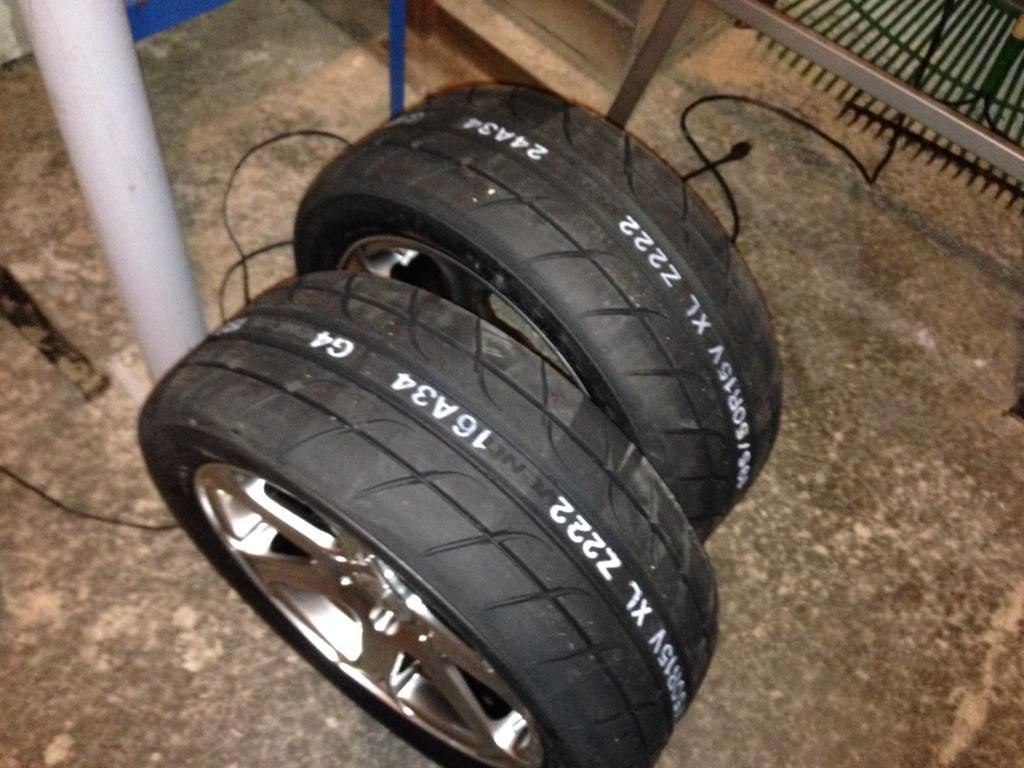

Just completed my new wheels, here's the setup:
Wheels: Genius Smart Car, Model: Darwin, Finish: Gun Metal, Size: 15x6.5
$681 Genius Smart Car Darwin Gun Metal Wheels For Sale & Genius Smart Car Darwin Rims And Tires
Lugnuts Dorman Wheel Lock Set - M12-1.50 Metric, Spline Drive
$36.05 Dorman® - Wheel Lock Set
Tires bfg g-Force Sport COMP-2 195/50R-15
$369.88 http://www.tirerack.com/tires/tires.jsp?tireMake=BFGoodrich&tireModel=g-Force+Sport+COMP-2
Installation ~$90, I got the car lowered during the installation as well
Lugnuts haven't arrived yet but here's a photo of the wheels. Total cost was about $1180.
The ride is a lot smoother; I don't feel every little bump in the road anymore, cornering is better, the car is more stable and isn't blown around by the wind anymore, top speed increased from 81mph to 87mph (checked via Scangauge 2 & gps)
