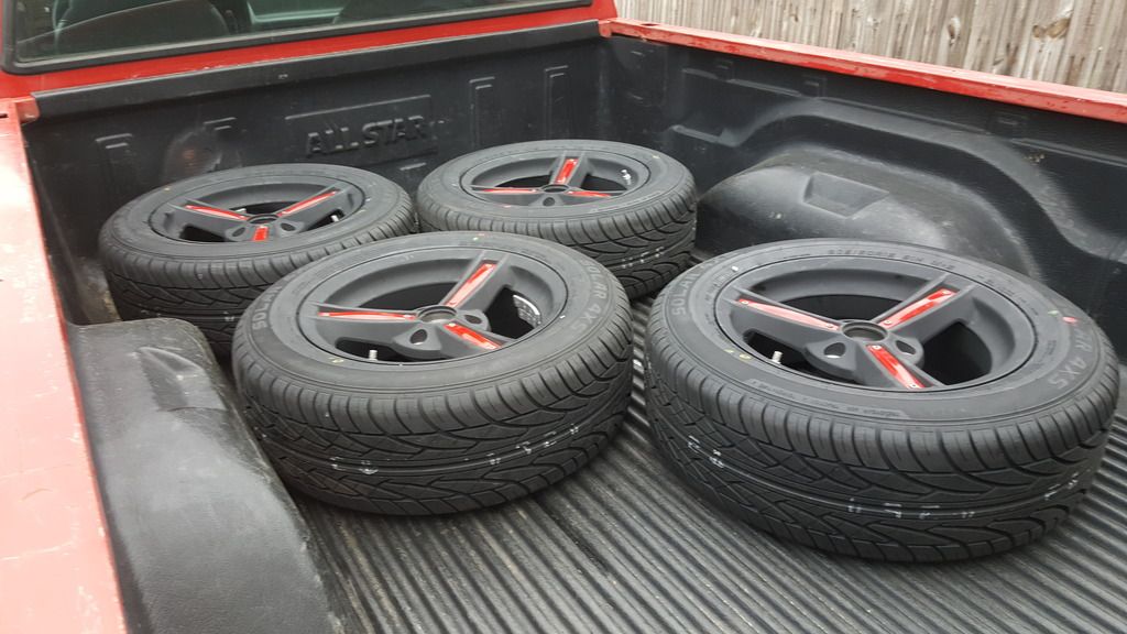

Smark I am gonna heed your advice and go to ceramics on the front of my Smart at the next brake change. But I have temporarily solved my unsightly black brake dust problem by buying new wheels that are matte black finish and the brake dust blends right in. (But I know ceramic pads would have been much cheaper than 4 new wheels from China). DCO
