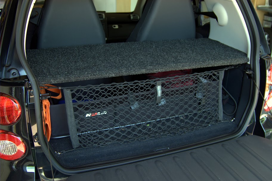

I've been needing a rigid cargo shelf for my dogs and other things. I wanted a level, carpeted area that could be installed and removed without tools, and could be stored behind the driver's seat when not in use.
I made it from a piece of 1/2" plywood (18" x 48"), a length of piano hinge, a rug, and some miscellaneous hardware. Descriptive pictures can be found here:
Cargo Shelf
I made a set of templates to help you cut the plywood to fit the car. The templates are four PDF files -- two for the right edge and two for the left edge. You tape together the two sides, and then tape to the ends of a piece of plywood.
Download the templates (Shelf1.pdf through Shelf4.pdf) from here:
http://personalpages.bellsouth.net/j/d/jdantin/files/
The piano hinge is 1.5" wide. Cut it to the 18" length of the shelf, screw it down, mark the centerline, remove the hinge, cut the shelf in half along the centerline, and then reattach the hinge.
The center support is a piece of scrap 3/4" wood -- I had a 2" wide piece, but anything up to a 1x4 should work.
I wanted the shelf to stay in place, but be removable without tools. I had some spare shelf supports that worked perfectly. I also added some velcro and pieces of rigid foam to the support brace to prevent rattles.
If you want more legroom, just make it shorter -- anything from 12" to 18" should work fine.

Just tried this mod and it worked out beautifully. Thanks Jim for the idea and the templates. I have almost zero construction skills and this turned out great! Easy and worthwhile, not to mention this cost me only $12 dollars compared to $149 for the official cover.

I'll try and get pictures tomorrow, just too busy this weekend and wanted to tweak the shelf a bit. Just finished making a new support rod that looks somewhat cleaner than my first attempt and had to resort to velcro to hold the shelf in place. I had hoped that by making the measurements a bit tighter that I could avoid adding velcro and those shelf holder thingies but that shelf was moving all over the place. Sorry for the delay in getting pictures.
41 Posts
Ok, I have added pictures in My SCOA Gallery. Just click on the link on the left and hopefully, they will appear. Haven't posted pictures before so it's all new to me. Anyway, I used a 1 inch dowel cut to 42" and capped with furniture tips (reversed and bottom cut out) to fit snugly in the little square openings on the side. I also used industrial strength velcro to hold the shelf in place on the rod but found that I needed to add a little height to the velcro for it meet. I'm still tweaking and will update this as I go along.
