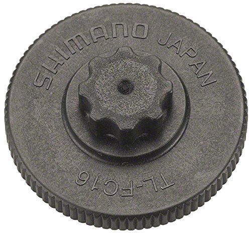

Here is my changing tool. Perfect fit. 9/16 in bolt head and double nuts for moving both in and out with the cartridges
Change time 5 minutes. Took longer to locate correct bolt in my tool chest.

Thank you for posting this. worked perfectly.
