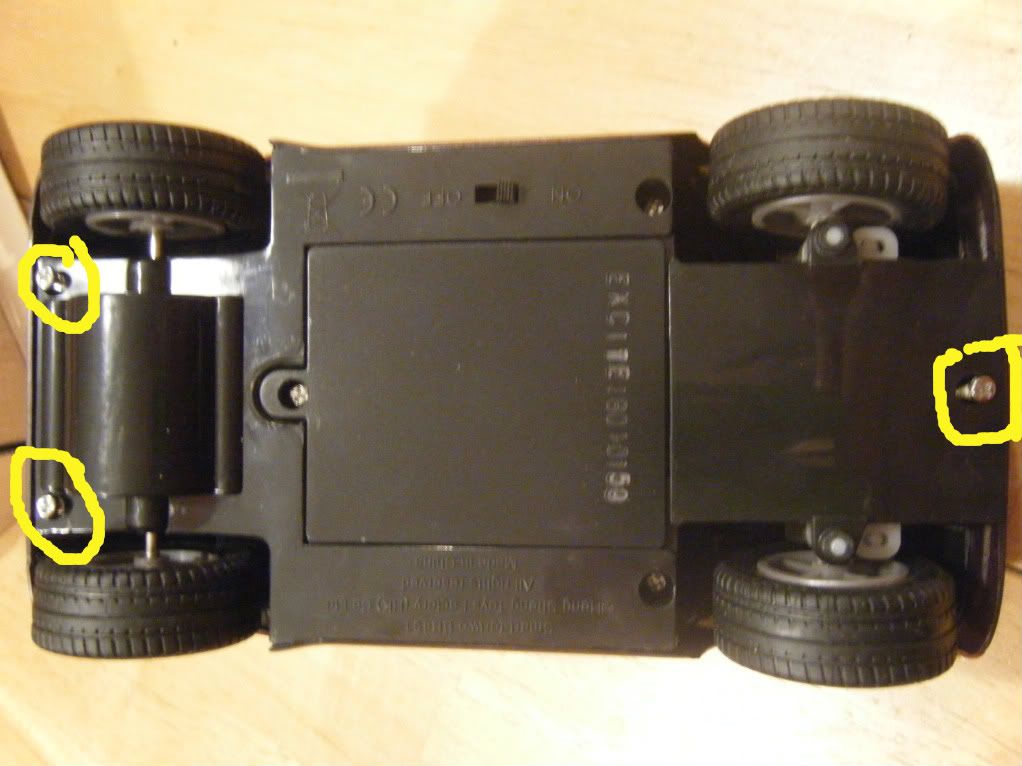

First, remove these 3 screws

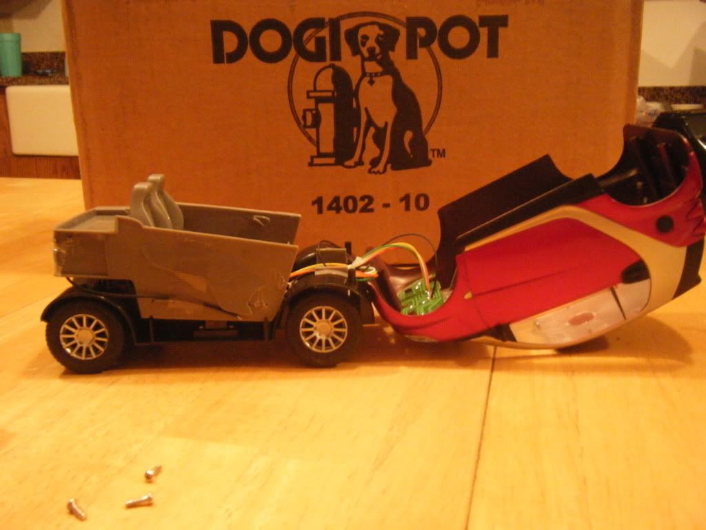

Then the top comes right off, but note the lighting wires still connected

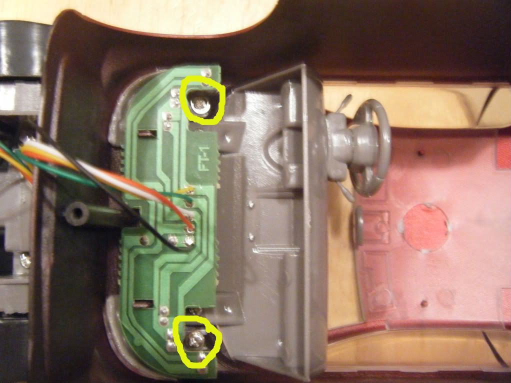

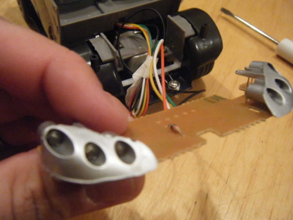

Loosen (do no't remove) these 2 screws, and the Circuit board the lights are on will slide to the front and out.
Once out, you can tape and paint the headlights:) and the body is now separate from the base

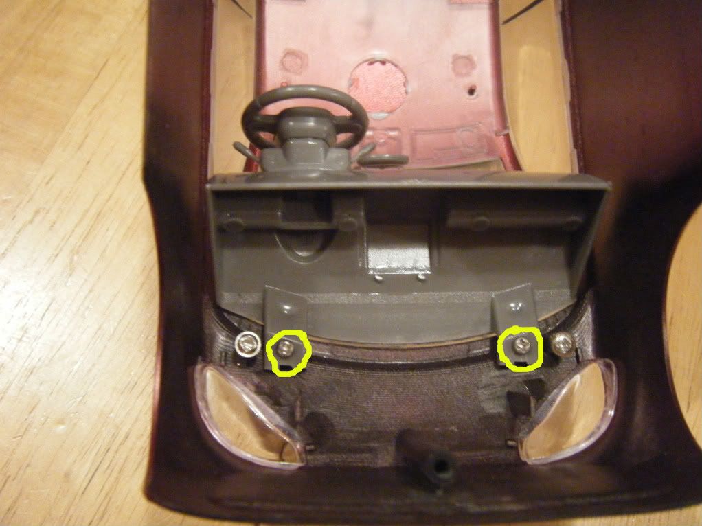

To remove the dash, once again loosen these two screws just enough so they still stay in the dash, but separate from the body
Pull out the Dash and you can tape and paint.

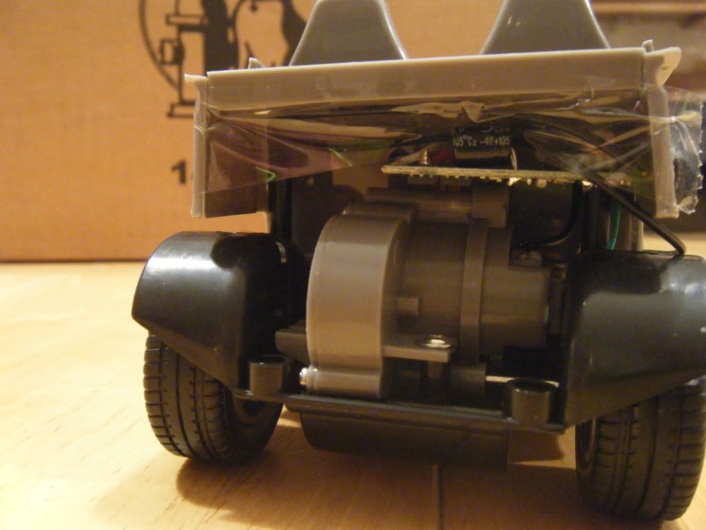

One last shot, The Power train really cuts into the storage space on this car

If you have the one with the circuit board on the front, there are 4 screws (2 for the board and 2 for the dash-they are not the same in the one I had)
note the one with all the silicon and the one without.
