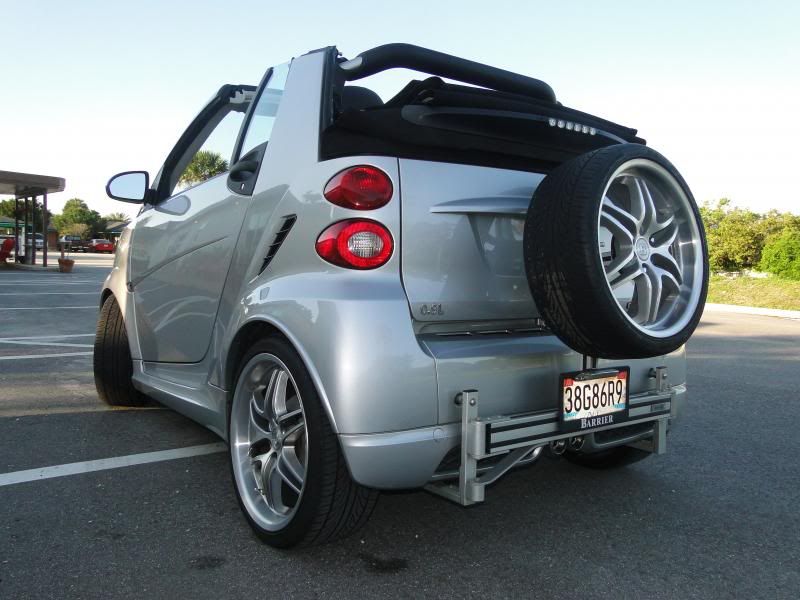

I bought a set of Carlsson fog lights and installed them on my 09 Brabus Cabrio. I bought a "new" dash switch bank to use the factory fog light switch and then on our way to St. Augustine, FL for our Anniversary we stopped at the SMART Center in Jacksonville to get them activated. ALL GOOD! Here's a couple of pics:
Whatcha think?
