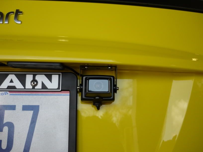

I have the Kenwood 5120 with nav and bluetooth (installed by dealer before I got the car). Just got the xm sat radio interface and universal rear view camera accessories for it. Anyone else add these items? I need some insight on where to put the camera and antenna, how to run the wires. Would love to do it myself to save $$, but I've never done anything like that and am kind of afraid of pulling apart panels or something in order to run the wires. Any suggestions (and pics!) are welcome.

I had mine done professionally . They mounted the xm antenna under the black plastic where the windshiel wipers are and easily fed it through the passenger door opening and behind the dash. They mounted the cam to the left of the license plate light and ran the wires under the carpet and up through the dash. They ran the bluetooth mic near the rearview mirror and ran the wires down the a piller to behind the dash. Make sure you get the bluetooth upgrade on the Kenwood web site that came out a few days ago otherwise there are major bluetooth problems. It has to be loaded from a computer that has bluetooth. I will try to send pics.

Napoleon12, thanks for the pic, but 2 didn't come through... Do you have the cabrio? and where did you run the wires each step of the way?
