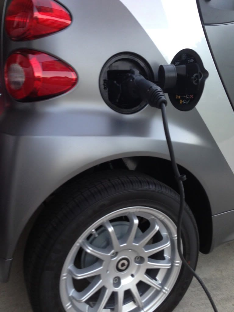

I have the same ClipperCreek. Bolted to the front of the house. It's waterproof, so it doesn't mind get rained on. The plug seals to the car when connected, so that, too, can get wet without trouble.

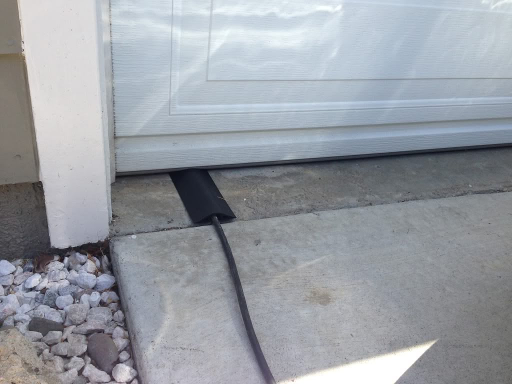

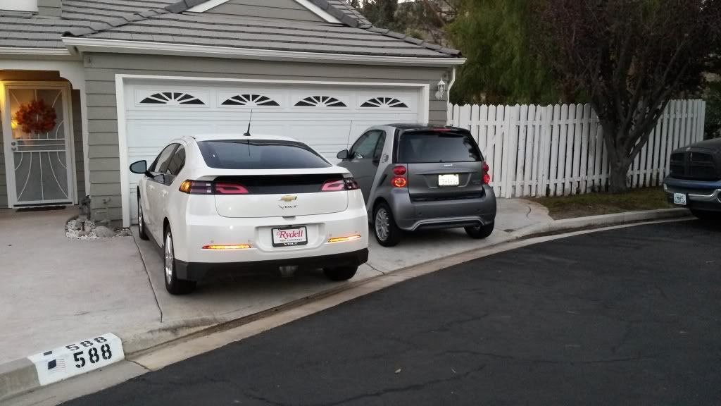

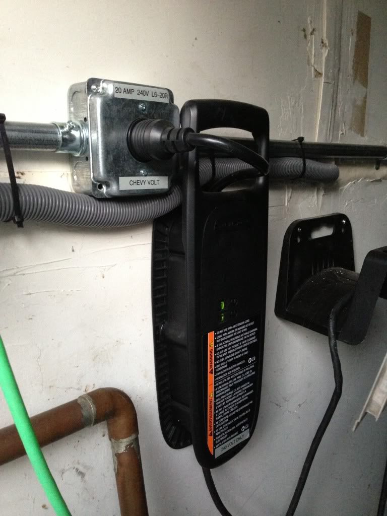

I converted a Volt level one charger to a 240 level two charger form EVSE upgrades
I have it mounted in my garage close to the garage door...
This allows me to charge my Volt in the driveway as well as charge my Smart outside
when done i can safely pull the cord back in the garage...
i cover the cord with a piece of safety rubber which protects the cable when the door is down
