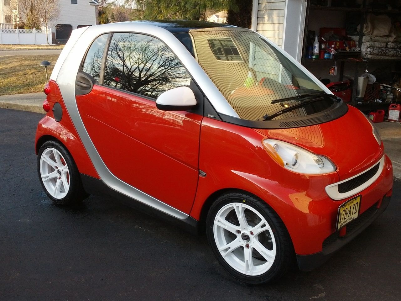

Bought new rims from teamdynamics and sensors from OE wheels and they've been on the car for a good bit now and they still haven't reset. We read the ID's on all sensors just fine with a scan tool for all manufacturers, but it wasn't able to program them. I've heard that the car just needs some time and I'm not sure of how long/how many miles that takes. Hoping that someone can shed some light on this. Thanks. :)

tried that, tried a bunch of button push combos, holding it, rapidly pressing it, hold and key on, etc.
I have the battery unhooked right now. hoping it'll go into a relearn or something that way.
358 Posts
Discussion Starter · #5 ·
about 70 miles over about 6-8 on/off cycles. Most other cars we've done at school reset within 25 miles. Of course the smart isnt in the same category as "most other cars"
Put the battery back in. Started it up and it was flashing for about a full minute and then stuck solid on. Definitely a different reaction, but not the fix.

First off, they look great if I didn't say it before (think I did, but I'll say it again :D)
