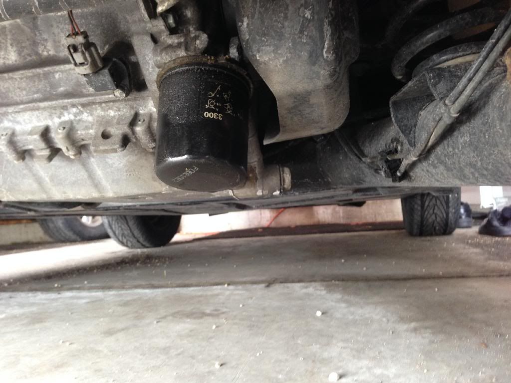

Hi all! Time to add another issue to the small list of problems going on with my car right now.
I discovered an oil leak coming from Tucker. Looking at the garage floor, this is something that just started happening very very recently.
There were at first just two spots of oil maybe one inch in diameter on the floor. One was dry, the other was just a tad damp. Today, I found a third one that's fresh.
Anyway, I noticed that there is oil dripping from the oil filter. Here's where I'd usually just conclude that there's something wrong with the filter, but I also noticed that there's some of dried up oil covering a very small area around the filter.
Looks like I'll be changing the oil early, just as a precaution.
Is there a possibility that this is just caused by a failing oil filter/drain plug, and not anything more serious like a leaking pan?
If the oil pan leaks, where would the drips be coming from?
If it is the oil filter, it'll definitely be the last time I use that brand...
17,378 Posts
Discussion Starter #2

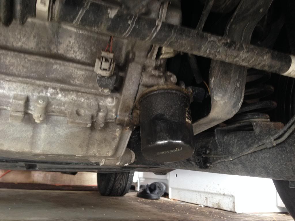

Here are photos!
Spots on floor.
Leak appears to be originating from the oil filter.
Oh thank heaven, the drain plug is dry.
I'm going to guess it's the oil filter.
Oil is looking a little dirty right now anyway, so I'll change it early. :)

Thanks guys! Looks like it's isolated to just the area around the top of the filter. I changed the oil 7k ago and it wasn't leaking then.
Oil is looking black now so I might just change it anyway just for
Maybe when the car scraped on some ice recently the filter could've been victimized.
I did oil the seal ring when I installed it...maybe the sucker is just too cheap to last 10k :D

3,455 Posts
Here are photos!
Spots on floor.
Did you tighten the filter untill it bottomed out...? New Oil filters are designed to tighten until they Bottom... No more of that 1/4 turn baloney... Smart has high pressure pump. Add to that Cold thick oil in the morning, and the pressure spike will burp past the seal on a lightly tighened filter...
