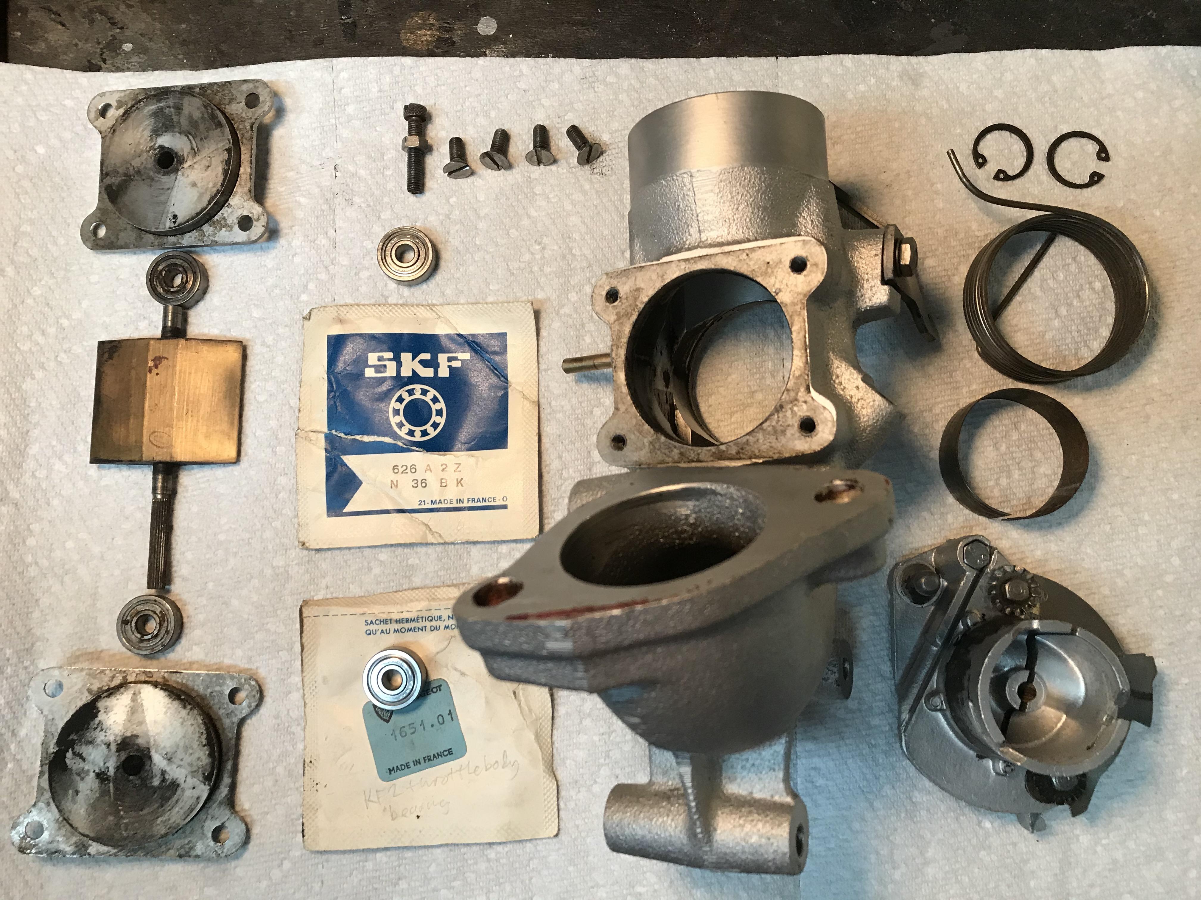

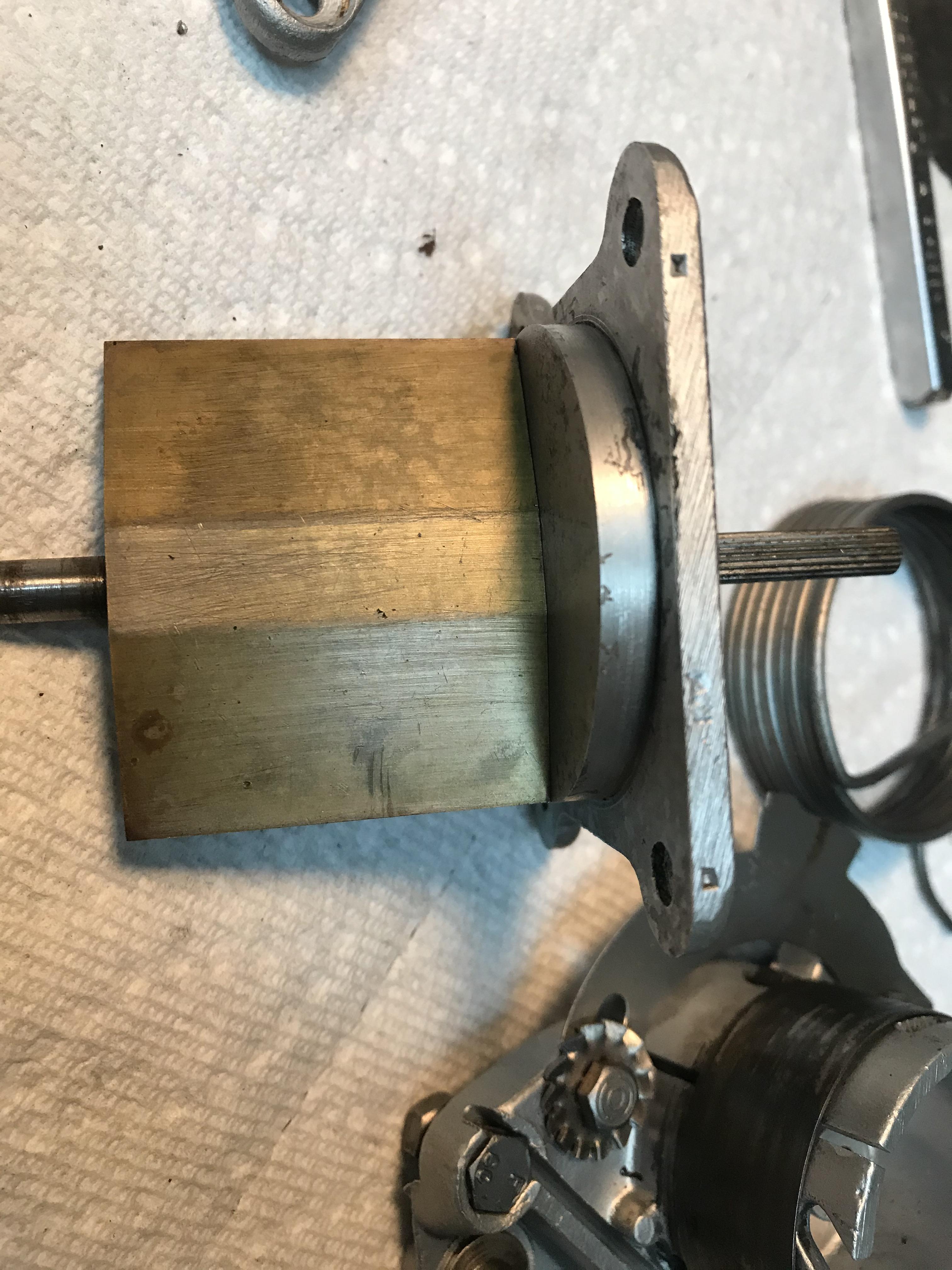

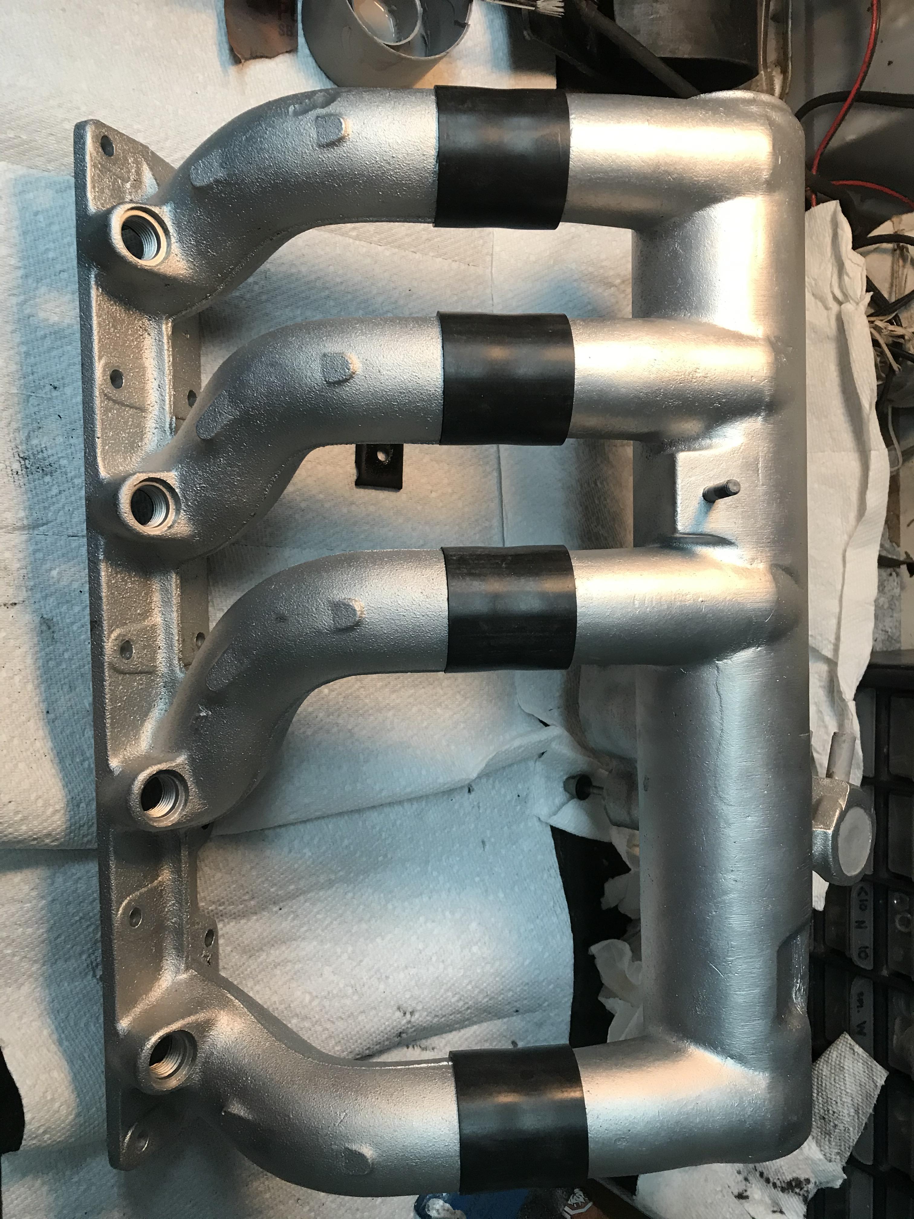

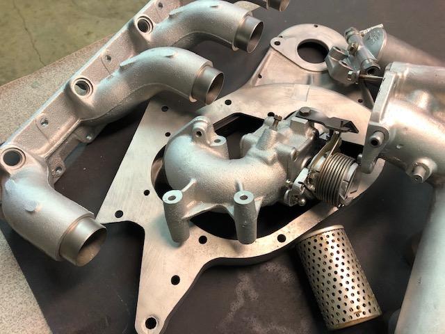

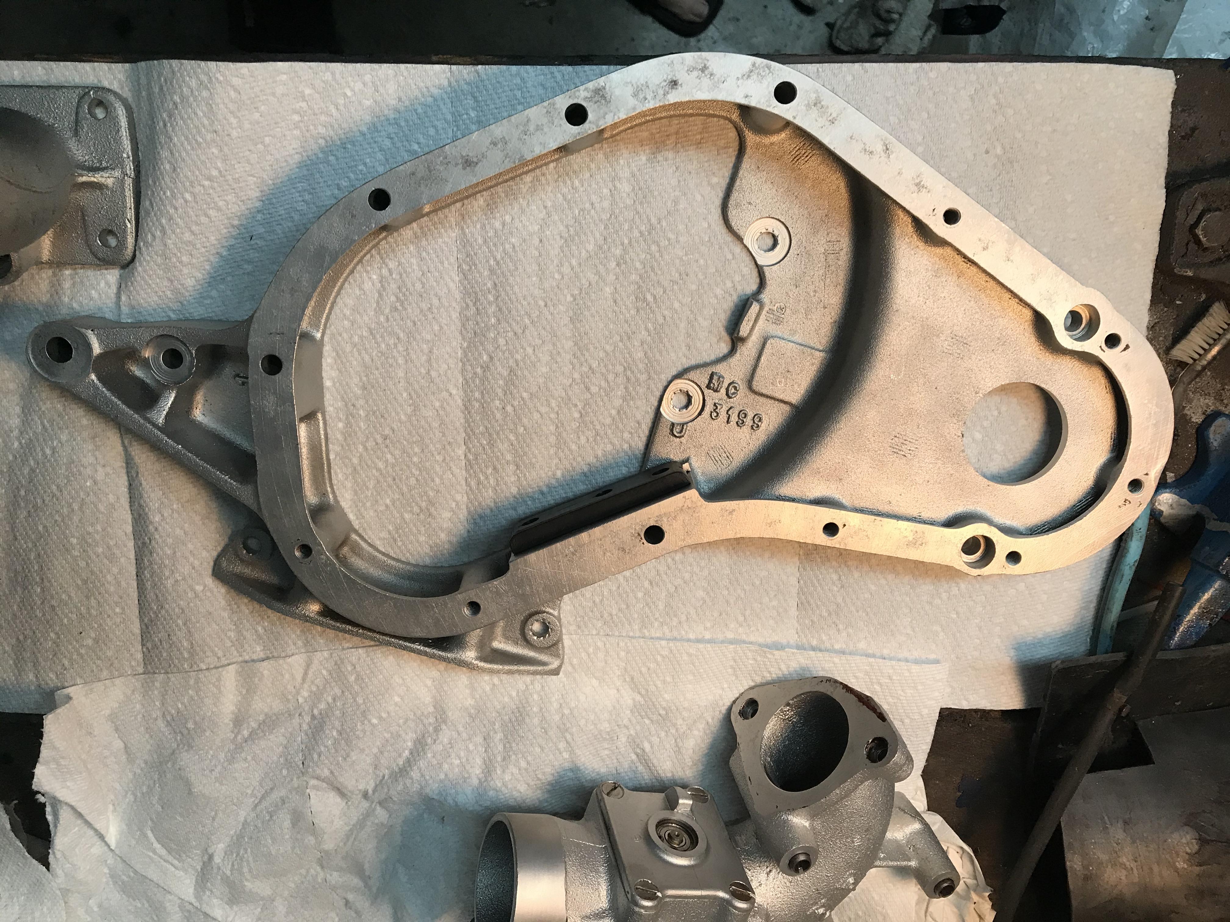

I picked up the vapour blasted parts this afternoon and took a few more photos. Very clean; the throttle body was disassembled by me for internal cleaning as well as the installation of new bearings.
Driving the old ones out was easy - remove two circlips on the shaft end, remove the throttle spring holder from the shaft after marking its position, unscrew the 4 staked screws on either side that hold the bearings, tap the shaft out with brass drift, tap the bearings out with a perfectly sized brass drift (there is the smallest of shoulders available to do that).
After its cleaned up I will reassemble it with the new bearings that you see in one of the photos. The old ones were shot, damaged by road salt I presume.

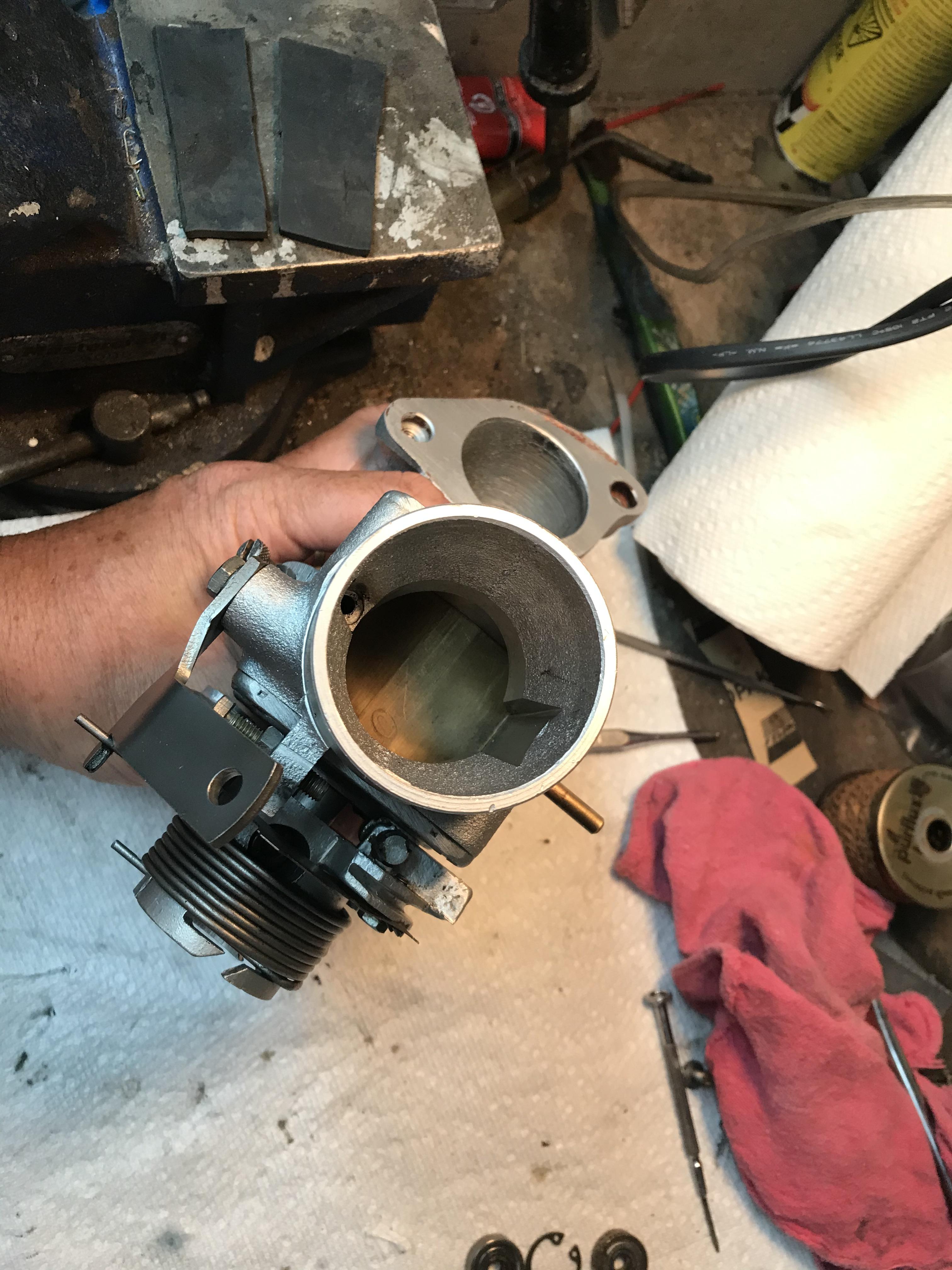

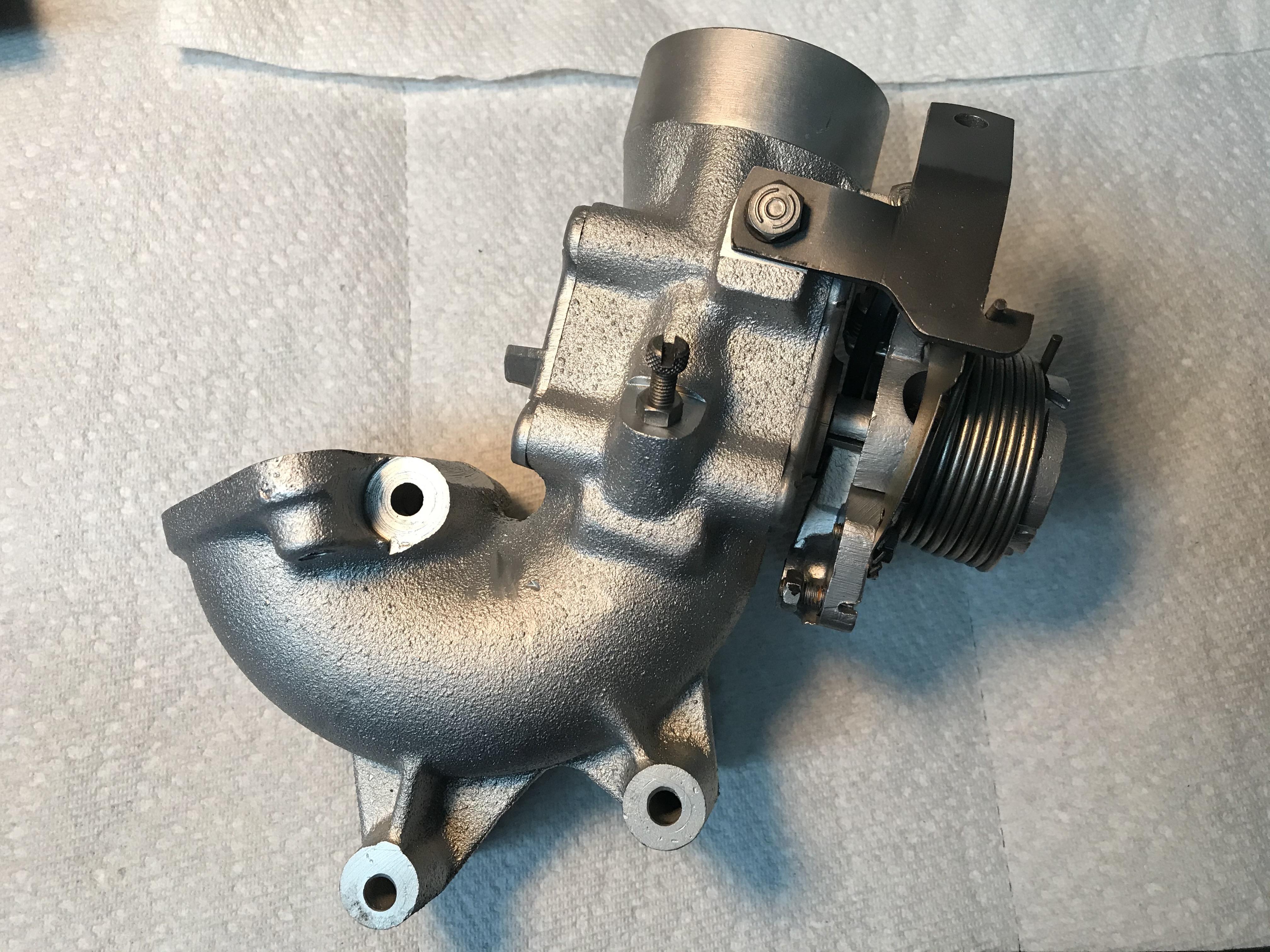

Throttle body is reassembled. The screws were staked at the factory because the distance between the two plates determines the clearance between the throttle body and the throttle plate. The large round inserts assure the air seal. I didn't stake the screws but I did put blue Loctite on them. The plates are snug to the throttle body but the screws are not "tight" but just touching the chamfered recesses in the two plates. Now that it is all together, the throttle action is magnificently smooth!

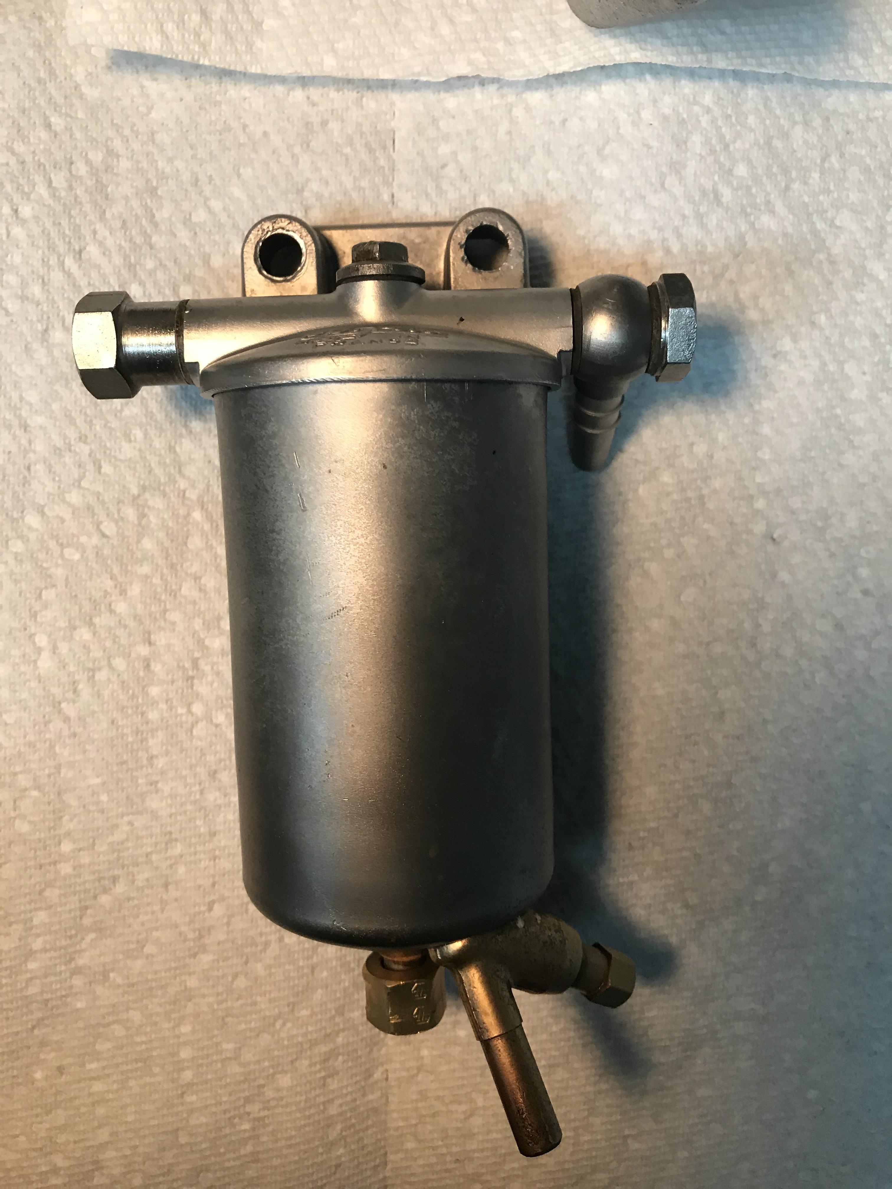

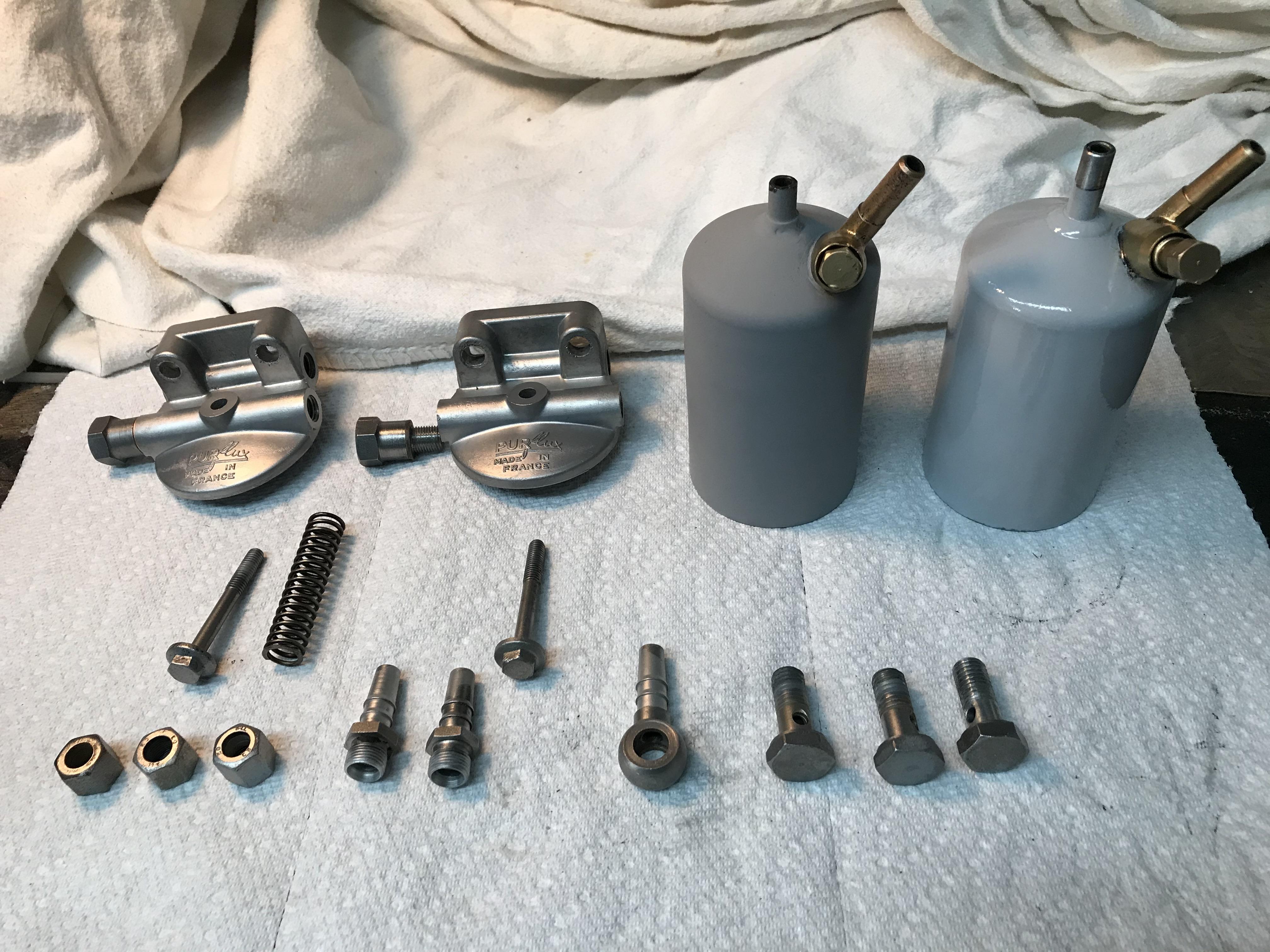

I also took the wrong fuel filter for blasting so the vapour blaster guy will do the "correct" one for free on Wednesday! The inside of the filter bowl that he blasted has severe rust pitting and the "correct" one does not.

The first Purflux fuel filter assembly I had vapour blasted was the wrong one (from a wreck that had a lot of undrained water inside it) and it had very deep pitting cavities inside the bowl as a result. So the blasting shop offered to do another better one. This happened today and the result is much better mainly because the inside of the canister was far less affected by corrosion. You can see both here, with the better canister on the far right.

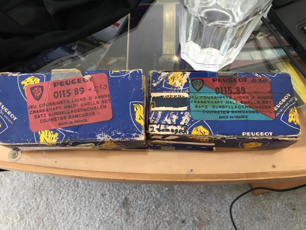

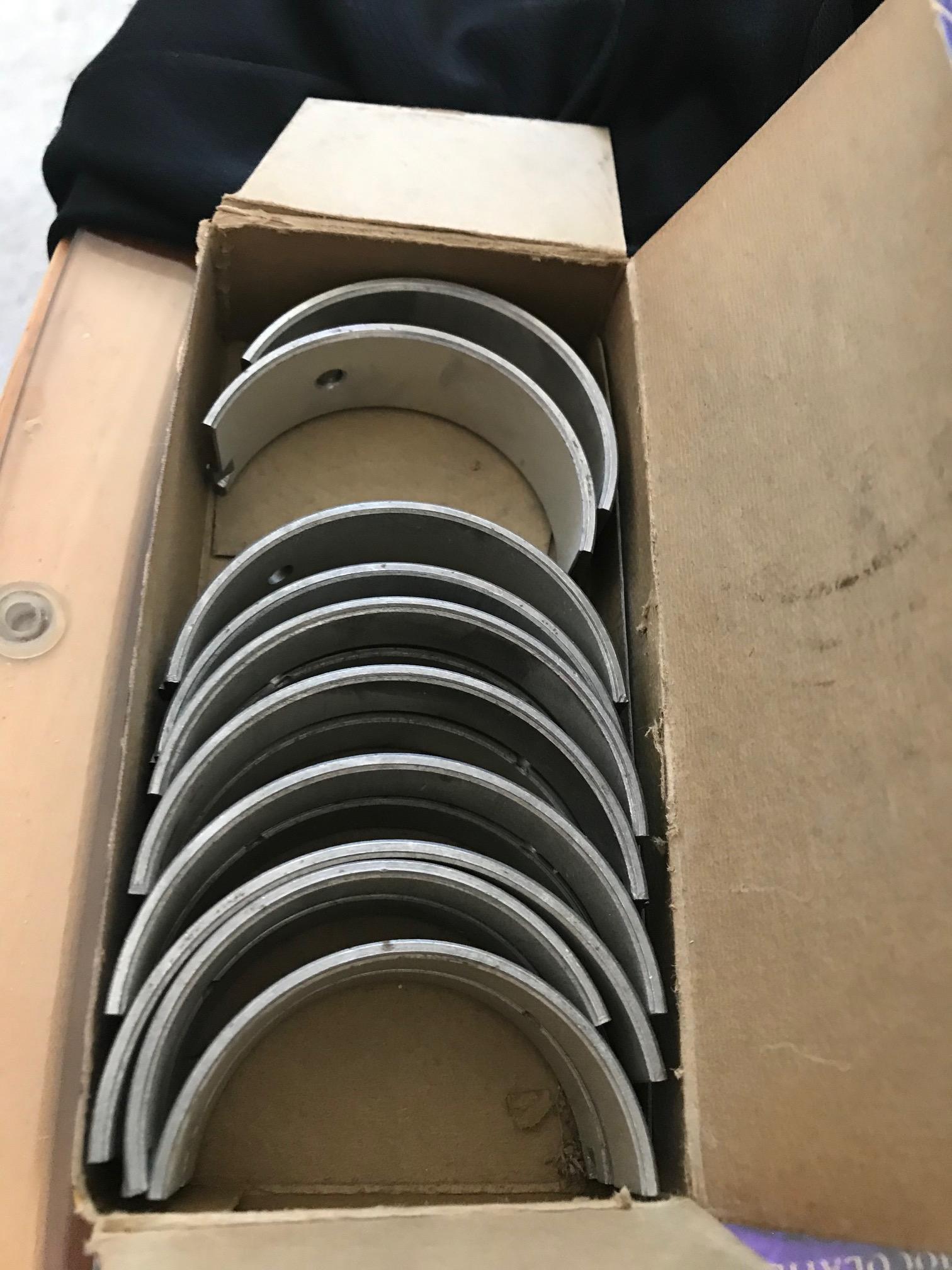

I got my second set of 0.5 mm oversized main bearings from Israel today. The first set (with the half red/half blue label) from Peugeot Classic in France had chattering marks on two or three of the shells from improper storage in the distant past. The Israel-sourced ones are excellent!

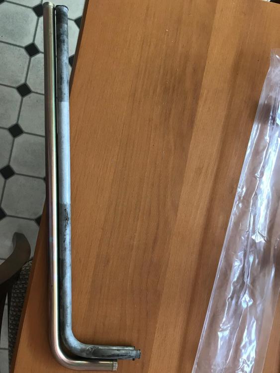

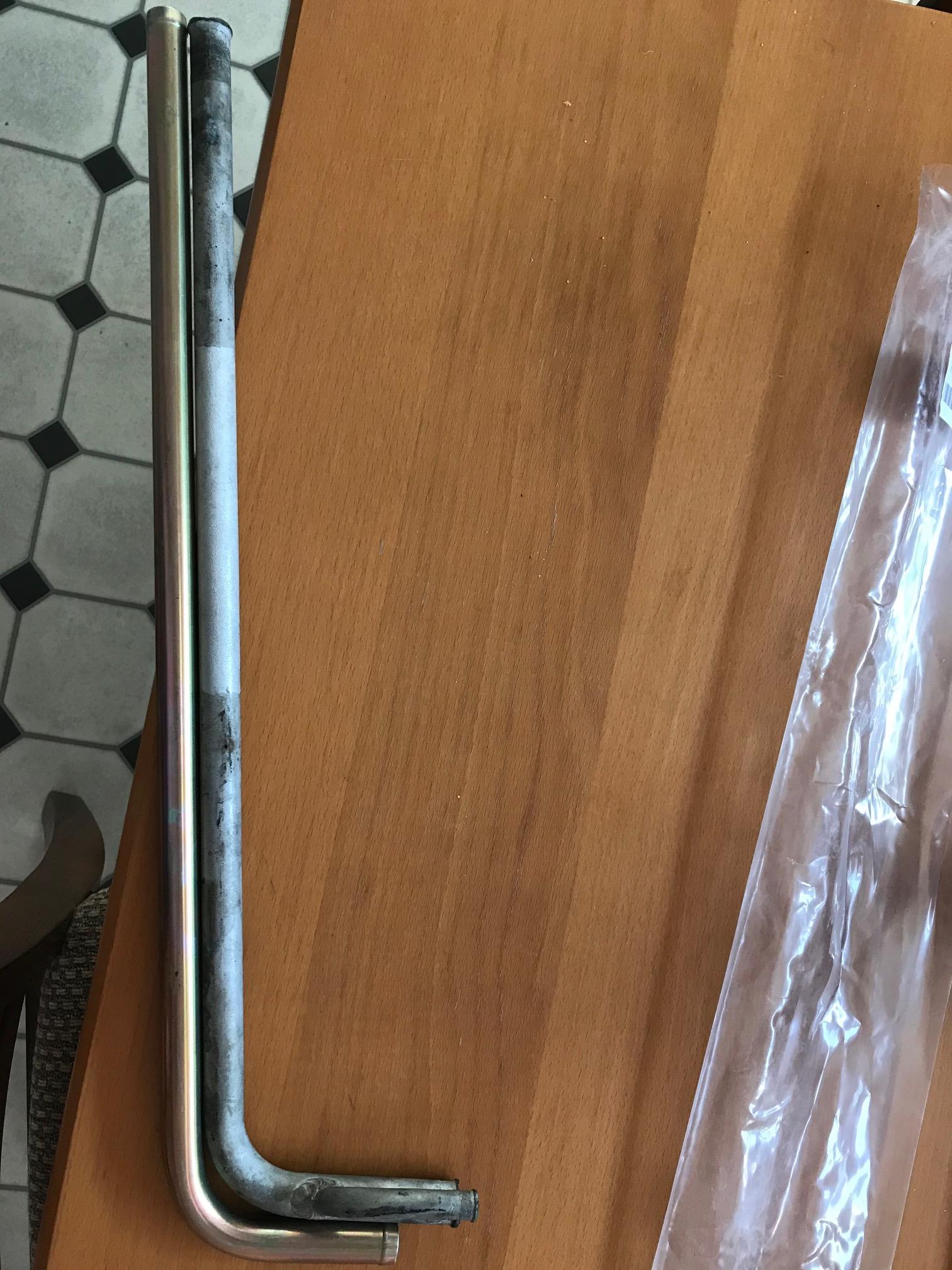

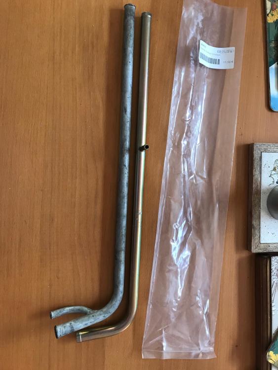

My 404's original heater tube, which takes hot coolant from the water pump to the heater core is beyond repair. The carbureted engines have a similar tube but its secondary water outlet is in a totally different location. However, the only new one available is for the carbureted engine, so I bought one of them at DEPANOTO and will have it modified in a local welding shop to adapt to the Injection engine format.
I had the old bit of pipe that leads to the injection system thermostat (cold start/supplemental air valve) cut off the old pipe and welded to the new one. The extra take-off on the shank (for the carbureted car) is still there but I will block it off with a rubber dead end clamped to it.

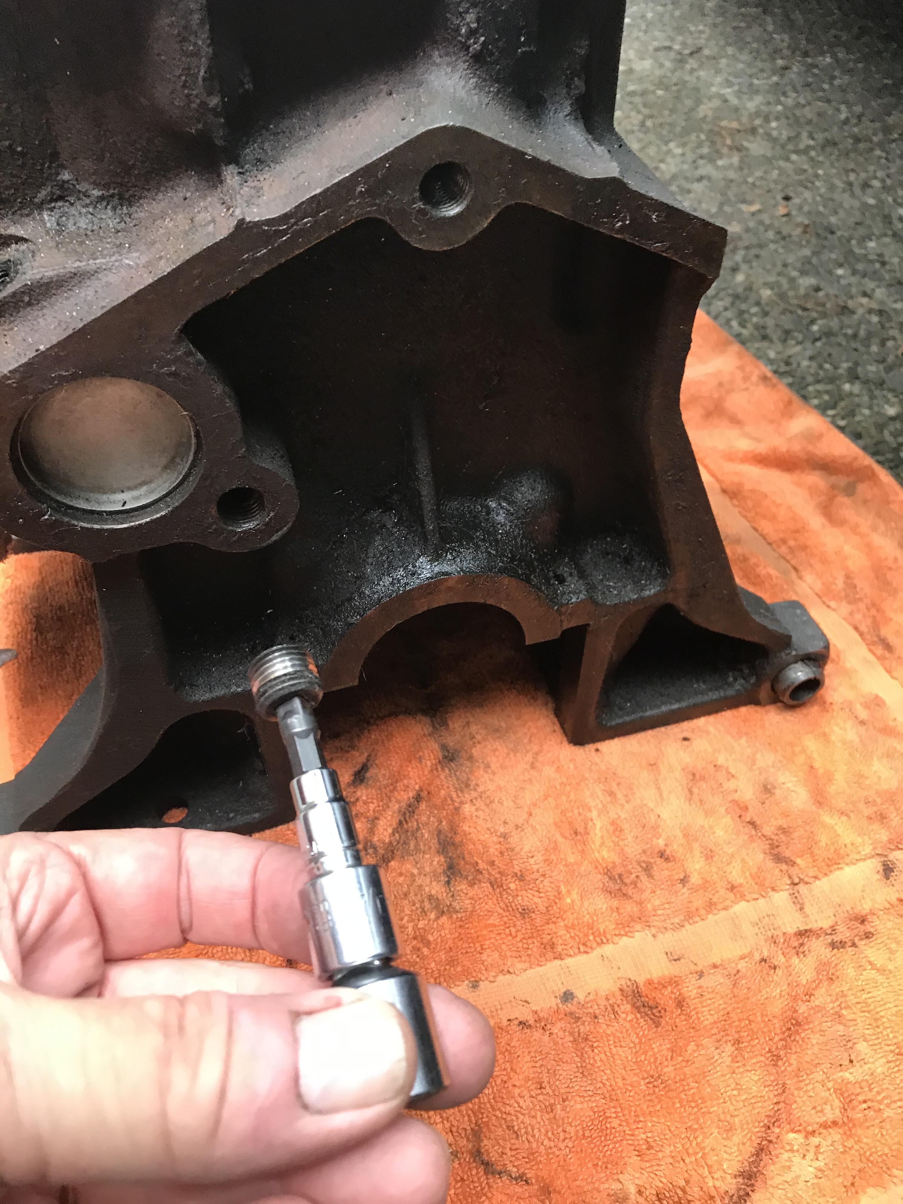

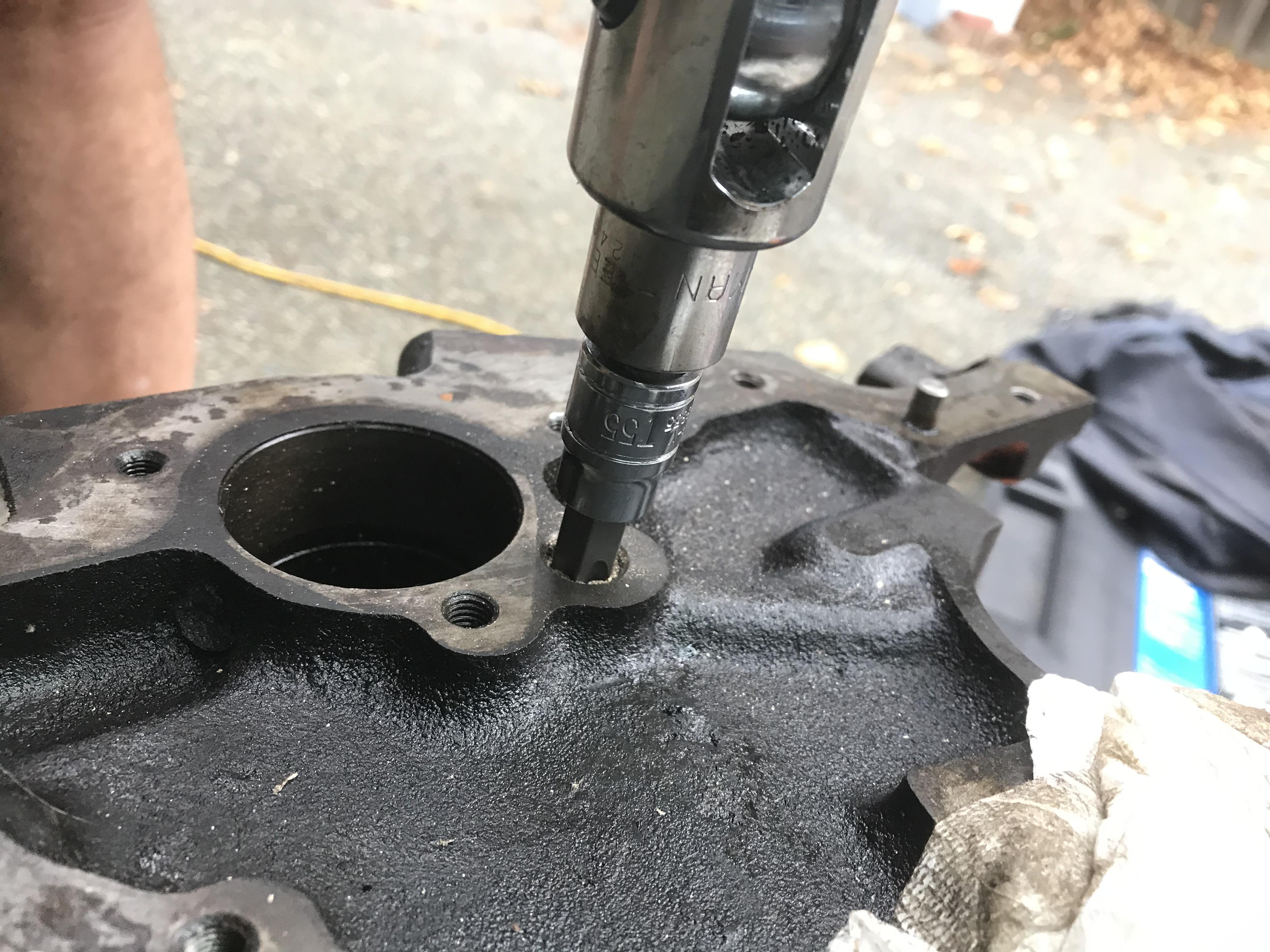

Also, I removed the three oil gallery plugs from the engine block today in preparation for its hot tanking in the shop I'm taking it to on Monday. They're brass and the square heads are a tiny bit smaller than a 1/4 inch drive. So I took a lower quality 1/4 inch drive and filed it until it fit. The first one on the rear of the block came out easily. The second one I tried, on the front of the block by the cam, stripped immediately (the square hole was rounded). The third one came out beautifully.
The front one that stripped was not all that much of a worry. I got a T-55 socket and used a Dremel to turn the formerly square but now rounded hole into an approximation of a Torx. I hammered the T-55 home and used a huge breaker 1/2 inch drive bar to turn it out. No worries.
Here is the sole rear oil gallery plug that turned out beautifully with my "special tool":

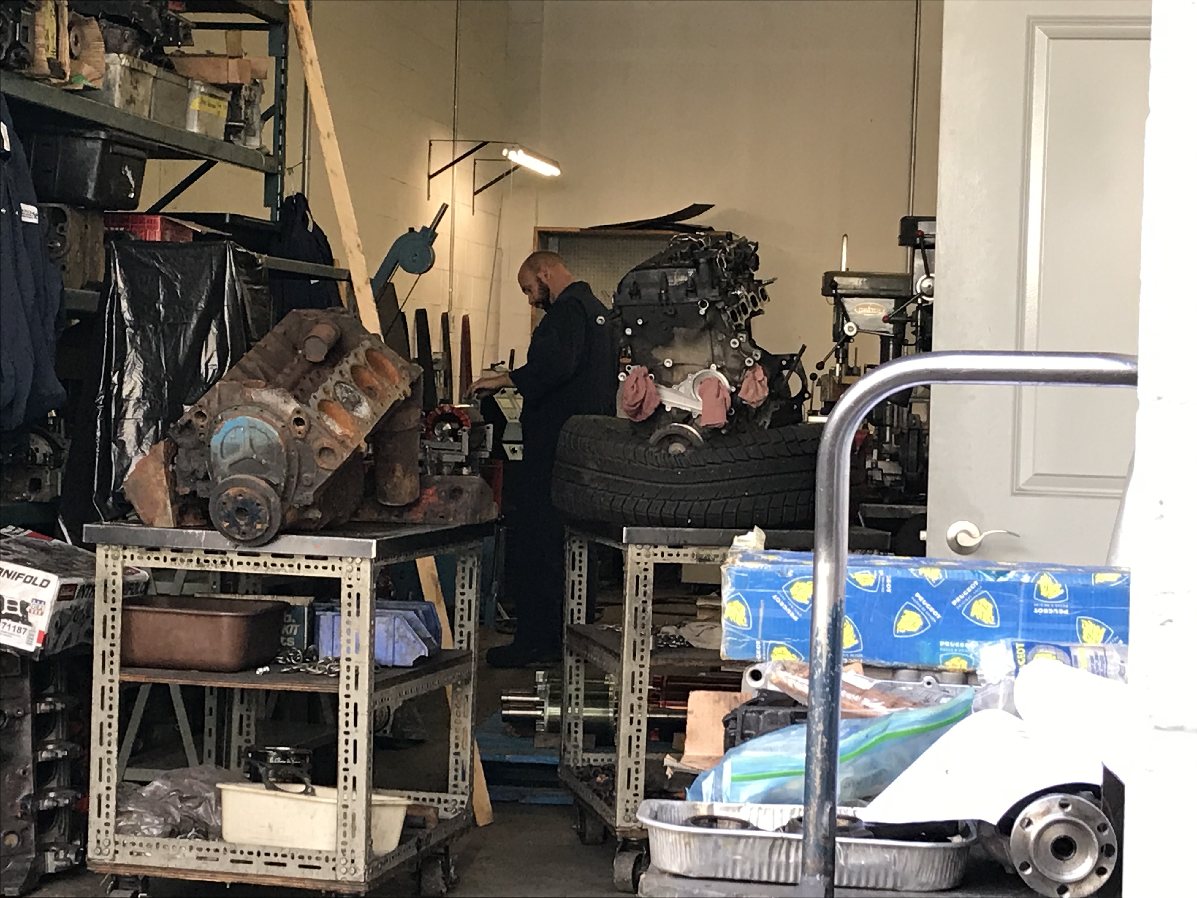

Yep, winter project, that's what it is all right! The stuff to be plated is at Victoria Plating and the engine bits that have to be (nearly all) are at Anderson's Machine Shop, which is where this photo was taken this afternoon.
The crankshaft will be balanced by itself first, then again successively with each accessory that is attached to it once all is done.

I got a call from Anderson Precision Engines in Saanichton BC today. They have cleaned and checked all the steel and iron 404 engine parts using a magnaflux machine. Good news: the crank is good, the block is good, rods are good.
Scope of work:
  • regrind and polish crankshaft, install sludge traps, balance it
  • replace valve seats and grind new valves to suit
  • replace small end bushes and fit to wrist pins/pistons
  • paint outside of engine block
  • re-bush all 8 rocker arms and match to new rocker shafts, reface their valve contact surfaces
  • clean preservative off the cylinder liners and new camshaft
  • reface flywheel, balance it alone, then on the crankshaft and then with the pressure plate
All of this is going to lead to a significant bill, but well under $2K CAD with taxes, so not crazy high. They do reassembly too but I think at this point that I'll do that myself.
