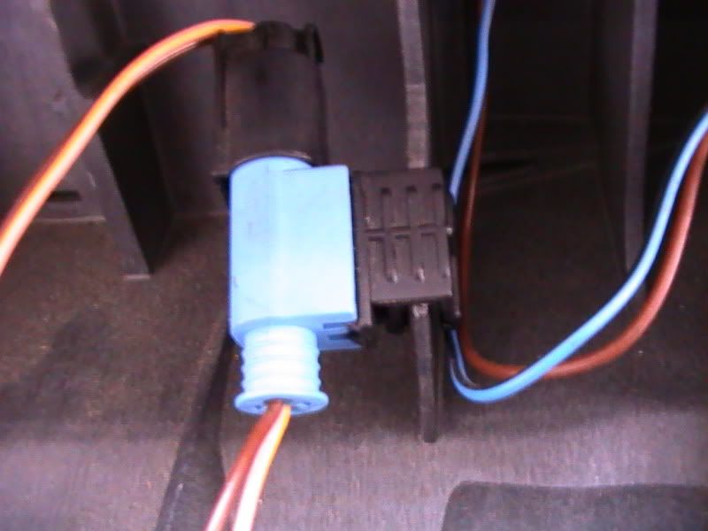

Below, this connector need be removed from the body....
Below, once released from body, push black tab and pull apart....
