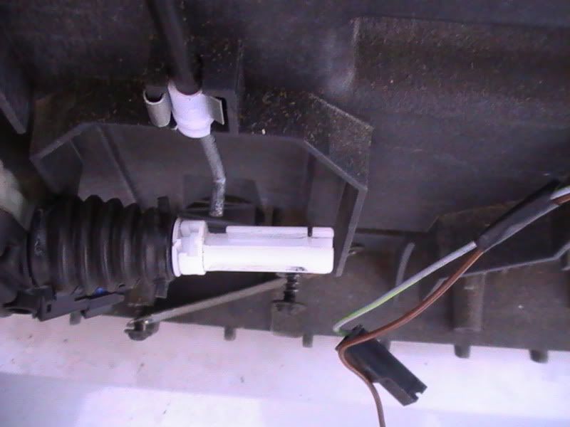

Below is the REAR WINDOW SOLENOID now ready for its operation....
Below, remove the top screw from the cross-strap and ONLY LOOSEN the lower to allow strap to get out of the way....
Below, follow the 6 pictures to see how to release CABLE from SOLENOID....
Below, release the POWER-CABLE from SOLENOID by PULLING the black tab (instead of pressing like the others)....
