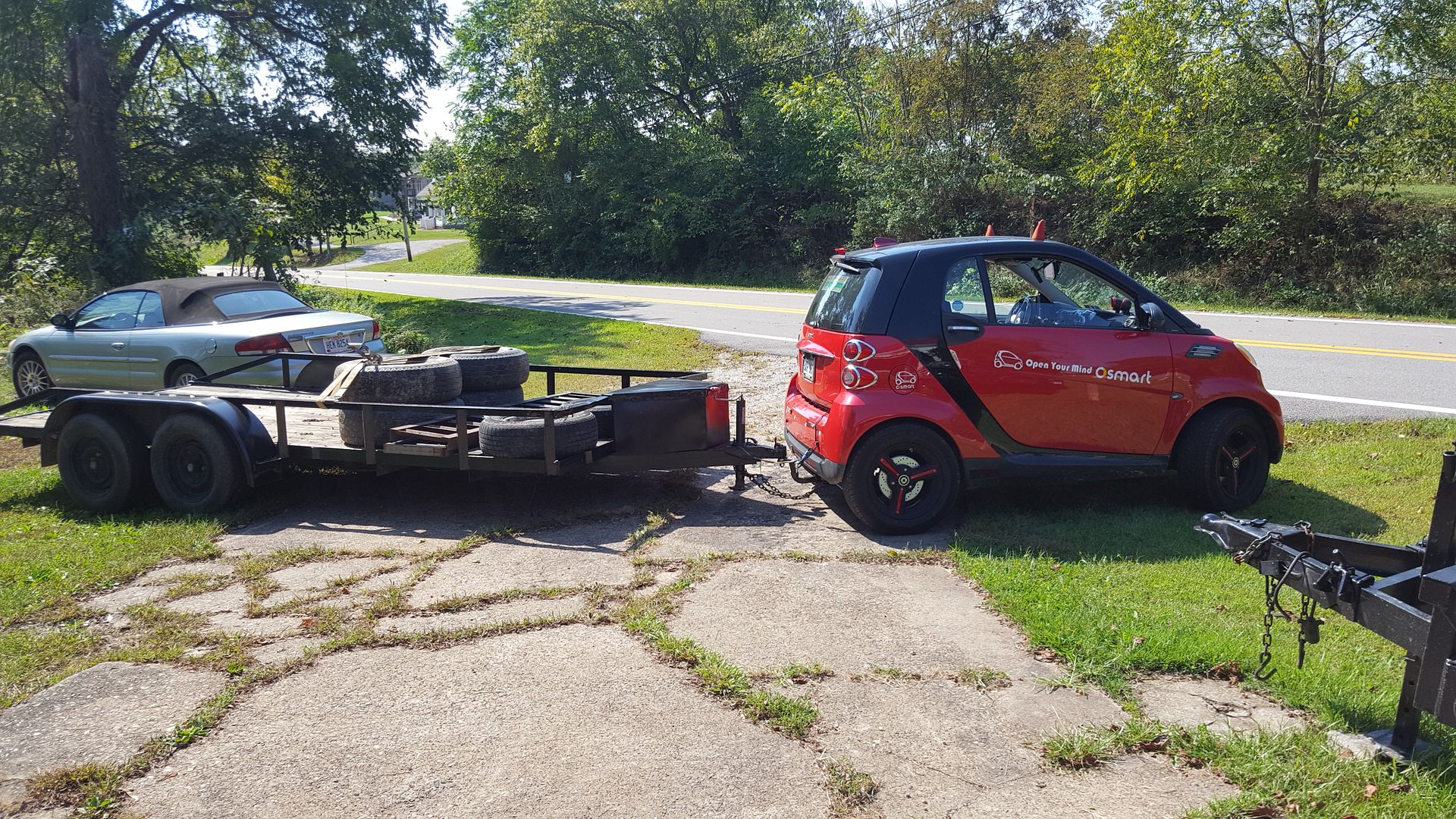

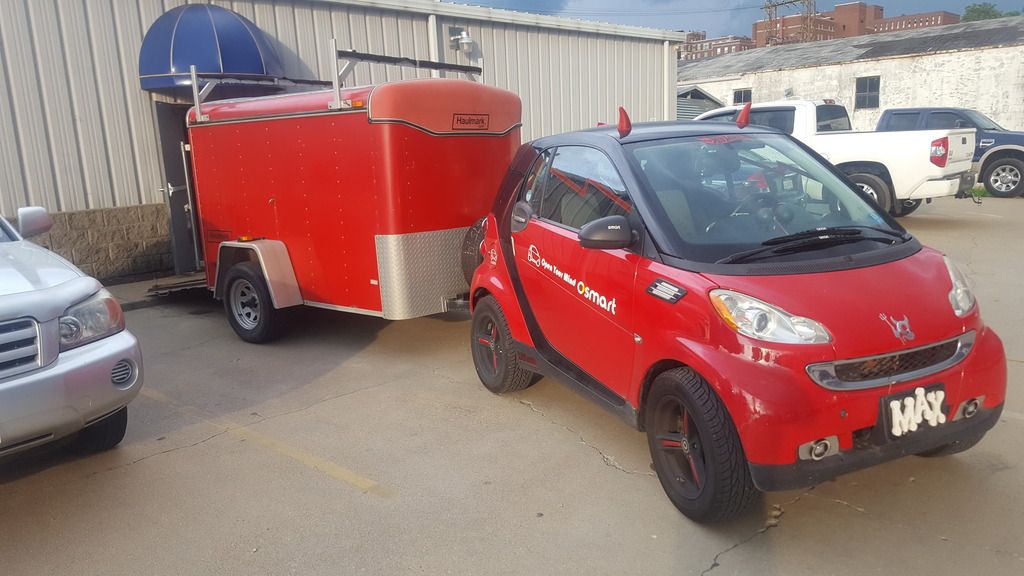

I probably push my Smart more than most because I do a lot of towing in these steep West Virginia hills. I can fill Max up from bone dry to full for $23. For 8.5 gallons of gas it's not going to break the bank to fill it up with high test. You get great mileage anyway and even it didn't help, my peace of mind that I'm doing everything I can to protect my car is well worth it to me. When I'm on interstate with that car hauling trailer in the middle of a long hill and Max is pulling his heart out for me keeping me at 60 mph in air conditioned comfort, it's very much worth it. I can only speak for me. DCO

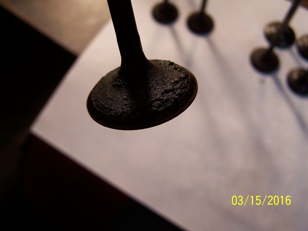

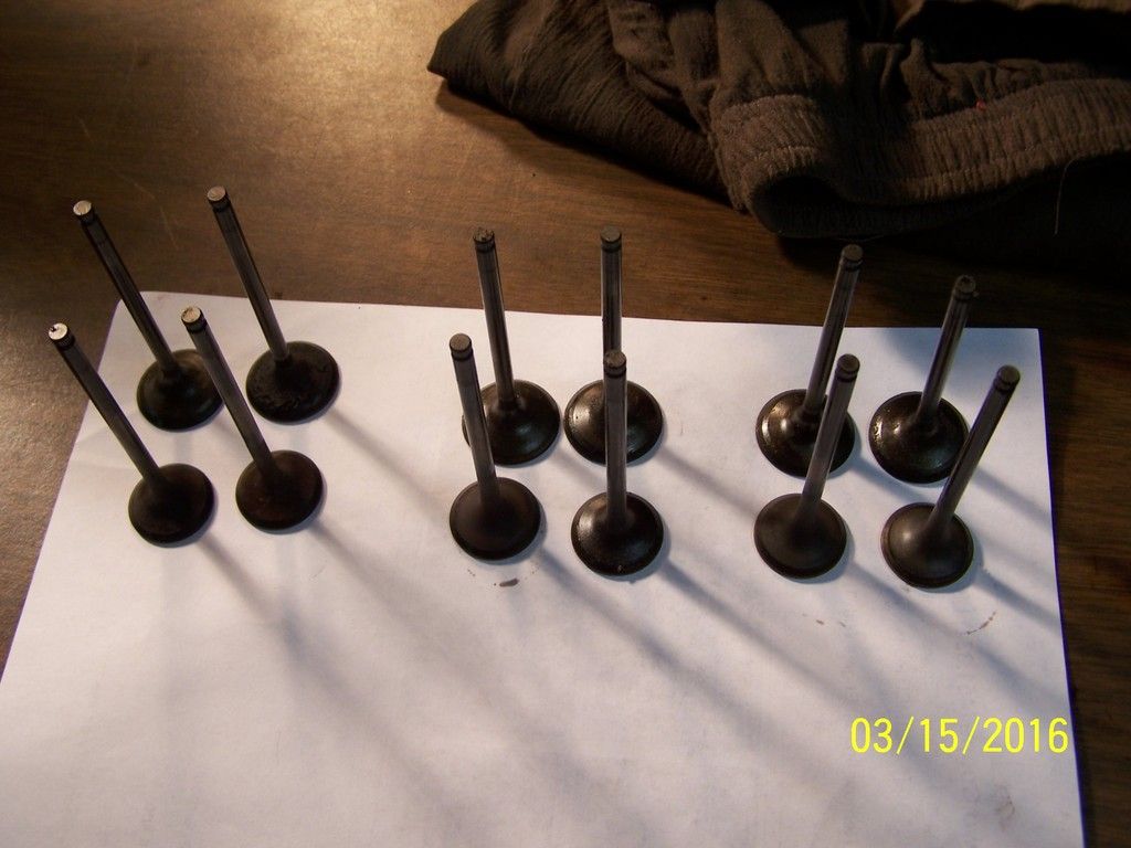

Here's pics of my valves out of my Smart that I removed at 36,000 miles. It cost over $900 in parts and machining to fix it and I did the labor myself. That repair would cost twice that at a dealership, maybe a little less if you could even find an independent garage that could handle the repairs. Shim buckets have to be done carefully and exactly. So the proof is in the pics as to what happened to my Smart before I bought it. It was a shock to me. I was getting ready to have a 2nd hip replacement and I thought I was buying a low mileage Smart that I could drive for a few years with only maintenance. What I ended up with was a car I had to drop the engine and repair a month after a hip replacement. Even with valves this bad it did not run noticeably rough. It just started lighting the check engine light. P0303 code. The sensors on the engine are sensitive enough that it was picking up a misfire before even I noticed it. I can't say that it was low octane fuel caused this or a dirty air filter or lack of oil changes. But what I am saying I do not want to go through the head rebuild again for some time to come. So as a "precaution" I run high test, use Marvel Mystery oil. I do an oil change every 5,000 miles because I do a lot of towing. Not everyone that plays with a loaded gun gets shot and I hope that no one has to go through the ordeal of finding good parts which I had to get from the UK. As I said earlier "I can only speak for me". DCO
