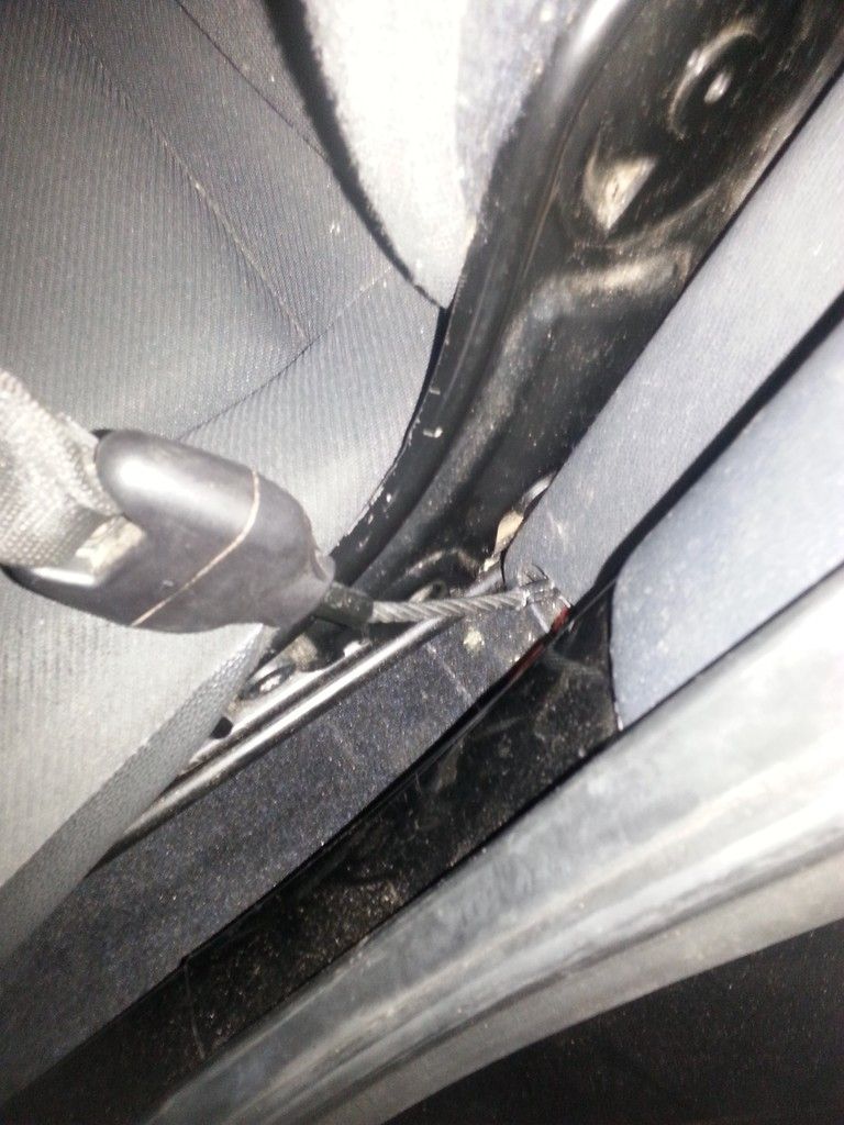

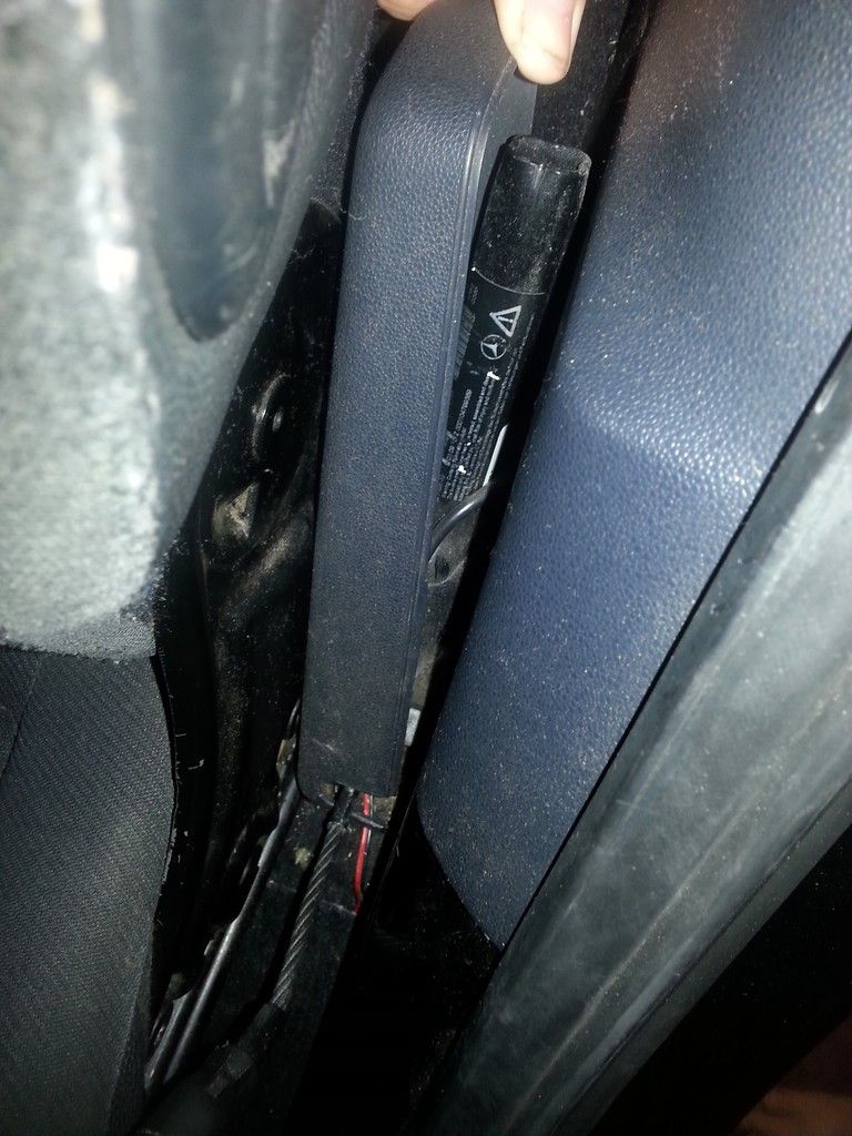

I bought a set of those padded seat belt protectors that velcro over your seat belt and say Smart on them. They keep the seat belt from digging into your chest when you are wearing the belt. I also pulled off those beach towels that I have been using for seat covers to throw them in the laundry and that's when I noticed my drivers side seat belt. The top of the seat belt is connected to the mechanism that rolls out the belt. The bottom of the seat belt fastens to a cable that threads up inside a mechanism.
Should this cable be pulled out of the mechanism like this or should the cable be back inside the mechanism?

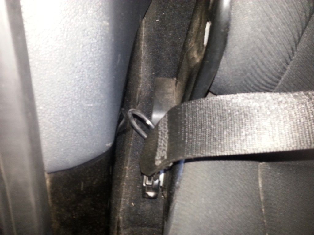

I thought maybe it's been tripped, but if it has it seems to me that the seat belt light or the air bag light or something should be lit up on the dash. The passenger side sealt belt is anchored on the bottom just by bolting to the seat frame so there's no way to make a comparison.

Mine also is connected by cable at the bottom. Think that is how they were designed. Seems my cable is same length as yours. Can't comment on passenger side since, honestly, I've never looked.

On my 2009 the seat belt is anchored directly to the seat frame for both driver & passenger.
I believe what you have is a seat belt pretensioner. It is designed to fire immediately before the airbag to snug up the seat belt and improve the effectiveness of the airbag.
Here's an image of one:
I am surprised to see it only installed on the driver's side and not the passenger's. Sometimes they are located on the buckle end of the belt. Possibly tests showed the need for it with the driver's smaller airbag and not with the larger passenger one.

DCO - My 451's been like that since delivery. It looks weird, but the exposed cable appears to be normal. :)

So it seems all smarts have seat belt pretensioners. So the style used on mine is apparently built into the seat belt retractor.
