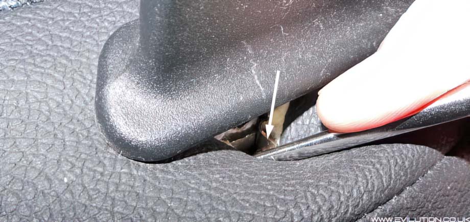

use a screwdriver on the lower side of the clip in the seat and pop the tab out per Evilution website, Nice write up with pictures (last link)
https://www.evilution.co.uk/files/smartinterior/seats/beltguide/beltguide3.jpg
