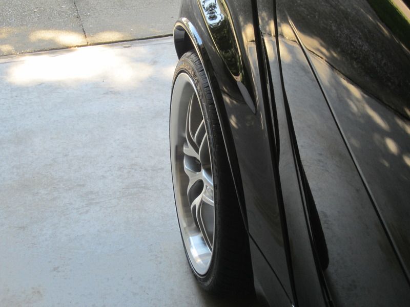

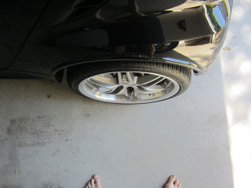

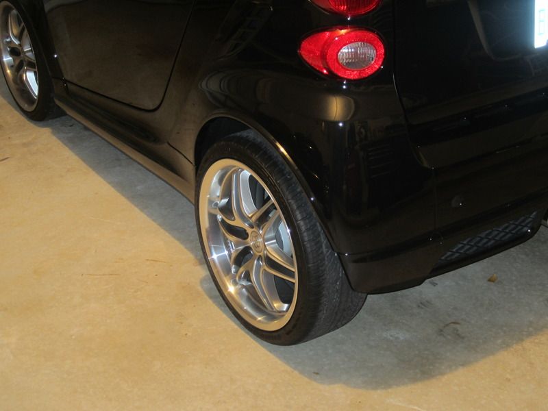

I have 7.5x17 Brabus wheels on all four corners of my '09 Brabus coupe. The tires are Hankook 215/35-17. The front are fairly flush with the fender, but the rear always seemed to set in more than I liked due to the negative camber. I decided to try some wheel spacers on the back. I started with Eibach 30mm as suggested by Tigerwong58. They put the sidewall just past the edge of the fender by about 10mm. I ordered another set of Eibach 20mm spacers. Now the fit is good in my opinion. The rear tire is just under the fender edge by a couple of mm's. I like the look and will try to post some pics.
By the way, I will probably try to sell the 30mm Eibach spacers. I put them on the car and drove it about five miles and came home and ordered the 20mm's.
We don't wear shoes in Florida........it's against the law.....
