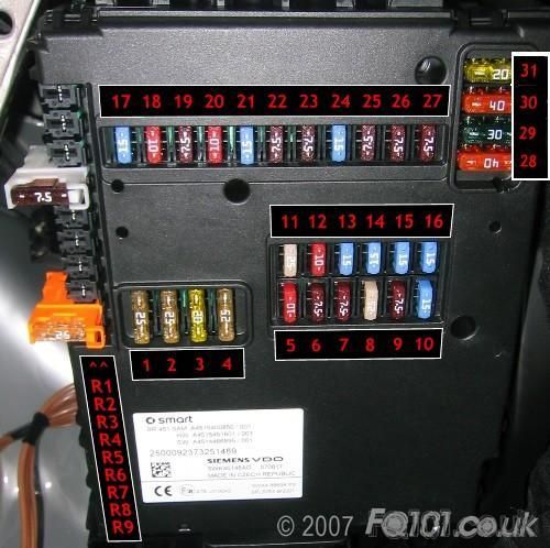

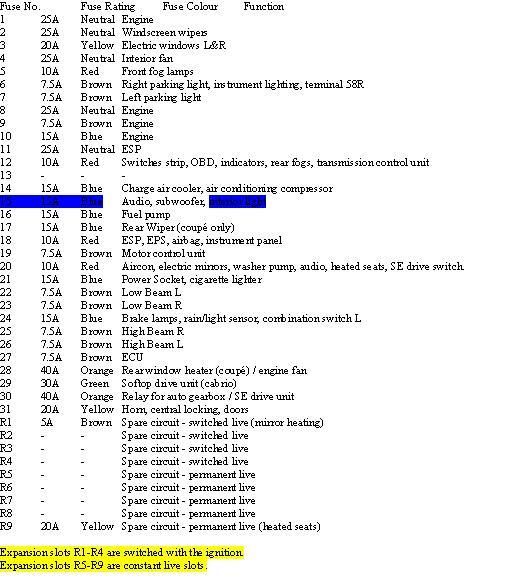

Jeandre check for a blown fuse. Fuse 18 is for the dash cluster and the tachometer and clock pods if you have them. Just get a pair of needle nose pliers and pull the fuse and look to see if it is burned out. I think I am remembering correctly that it is fuse 12. Here is a diagram of the fuses to help you locate it. It's a little bit tight trying to get at the fuses under the dash. DCO
3Smarts. As silly as it sounds be sure that both doors are closed and the hatch is closed securely. I spent 15 minutes one night trying to lock my Smart after getting the groceries out of the back. I closed the rear glass but it I guess I didn't get it latched. That is usually my culprit. For another test of the system, with your Smart running and the doors closed hit the lock button on the button bank. It should flash. Then shut off the car, remove your key and exit the vehicle. When you close your door it should now be locked. If that doesn't work you could possibly have a blown fuse. Fuse 31 is the one you need to check to see if it is blown, see the above picture for the fuse box diagram. If it isn't a blown fuse it is more than likely a faulty relay inside the SAM unit. Your key FOB doesn't work it nor the dash button bank and I would be pretty certain that both doors and the hatch solenoids wouldn't go bad all at once. If you put a fuse in it and activate the locks and the fuse blows again it would mean either a shorted out lock solenoid or a rubbed bare wire someplace. DCO
