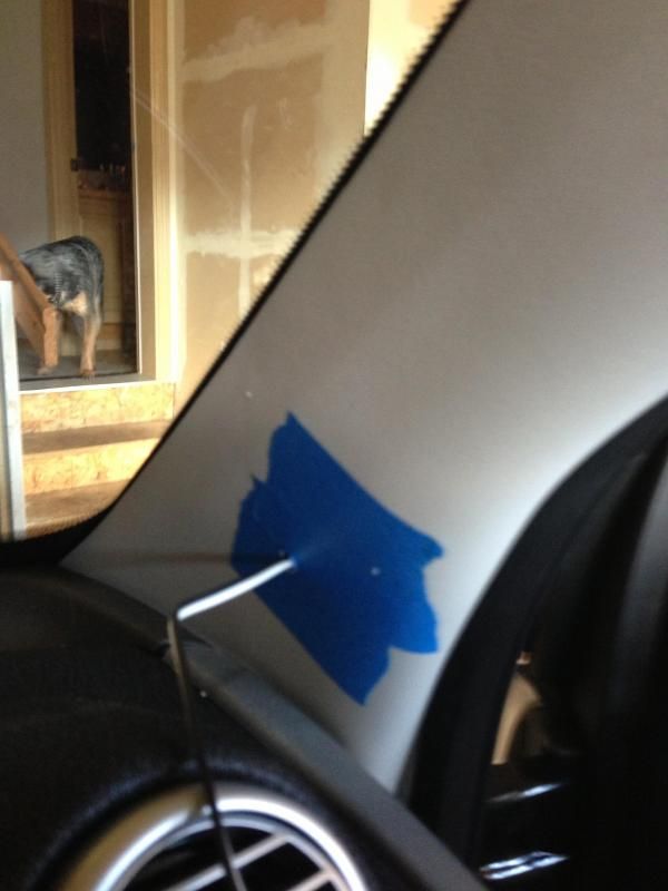

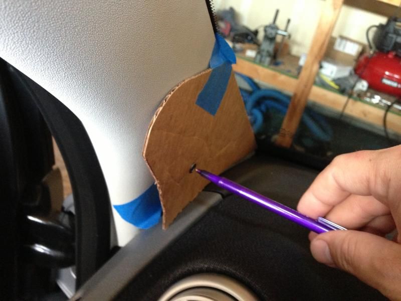

While trying to figure out how to get the A pillar trim off to install tweeters, it occurred to me that I didn't need to. I mounted them fairly low, but the wire fed very easily behind the panel.
I used a cardboard template to get the holes in the same place. I pressed a grommet onto the cardboard to make it easier to mark the surface through it. After that, it was very easy to feed the wire through. If you planned to mount them higher, you would probably need a fish tape.
