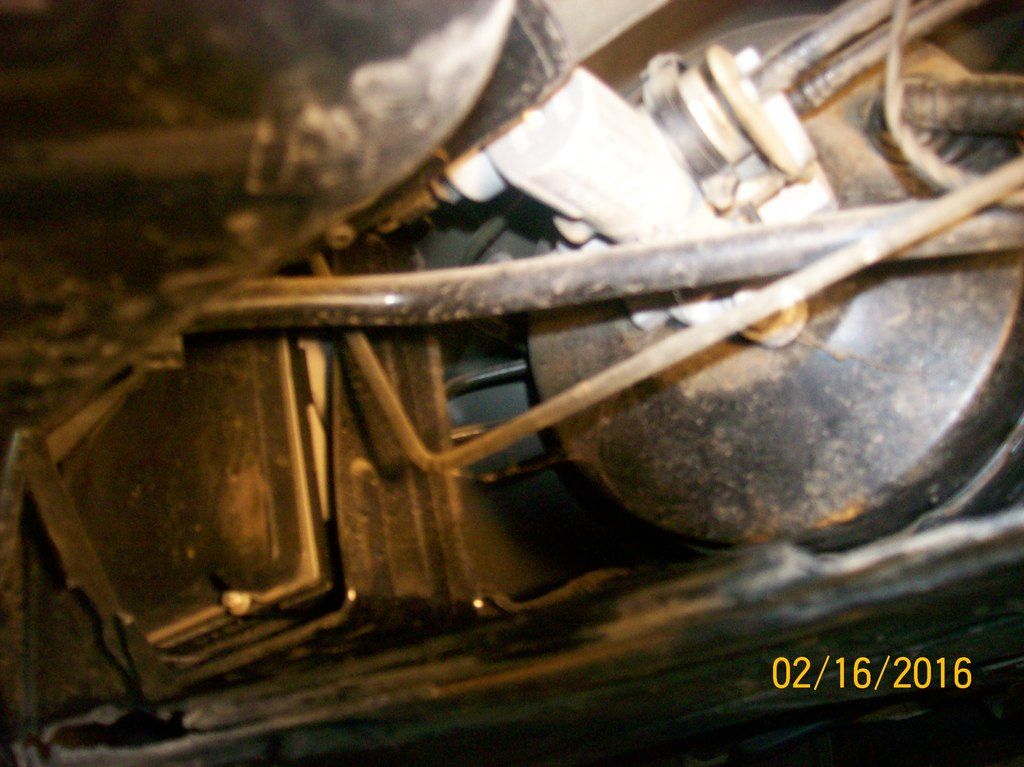

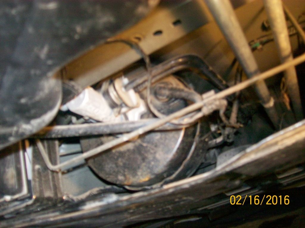

There's a few things under the floor of your Fortwo in the seat area. Charcol cannister for gas tank venting and ABS brake module and master cylinder. Here is a couple of blurry pics(I had a crappy camera at the time) taken under the car from the rear facing forward. It's dirty under there and it took a while to get it all cleaned up so it could get dirty again. DCO

Thank you Jo E Lefors for that helpful picture. There have been so many people in the past have a faulty Subwoofer under the seat and not know what to do. I tried to describe the best way to unhook it, but since mine doesn't have a sub I couldn't provide a picture. You solved the mystery and I'm sure there will be many more people need to see that picture in the future. DCO.
