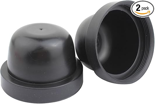

Ok, so the bulbs must have changed design over time, and there is a large load resistor as part of the wiring to the bulb. This piece is way too big to fit into the headlight boot cover.
The headlight reflector is open to air without the boot, so dust and moisture can get onto the reflector and bulb without it.
I can’t find any boots substantially taller than the OEM piece, maybe a half inch taller if that, and I’m not sure that’s enough. However, I find I can stack the boots. The OEM pieces fit into each other fairly snugly, so if I cut the closed end off, I can shove it into the open end of the other boot and gain maybe an inch.
Better yet, I can buy an aftermarket boot that is a half inch taller, and stack those with the OEM boot to gain more than enough room. I think I’m going to order these:
unless someone has a source for taller boots with a 70 mm inside diameter fitting like the stock boots.
Or unless someone has a better idea!

The new boots arrived. They are the kind that can fit many different diameters of headlight bucket lips - you cut it at the level that has the size you need. Unfortunately, one of the boots was already cut and I need it at the full size so these have to be returned. Grrr…..
