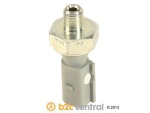

Well it's been 5 more days and I've driven the car and the oil leak is back. I jacked up the car and got under and removed the plastic shroud the the oil splatter is around the oil pressure sending unit and oil filter. Oil is on the inside of the bottom pulley and blows back on the muffler just enough to make a smell. The belt tensioner is soaked and if were connected to oil in some way I would swear that IT was the leak! Oil on my new belts can't be good for them.
This weekend I'll try to raise the car and run the engine just enough to pinpoint it. It seems to leak more at highway speeds. I just added about 8 ounces of oil so that's the amount of loss over about 1 week. So if I can't pinpoint it for sure I'll just replace the oil sending unit and filter and if it still leaks it has to be the front crank seal. I don't think its the seal as the whole area would have oil residue on it. The alternator side of the front of the engine is dry and no oil. It'd just a pain right now. I use the Bosch 3000 oil filter. On Rock Auto they have them for just under $4.00 whereas at the local Auto Zone they're $6.99. Found the pressure switch somewhere online and it was just under $20. I'm not a tightwad by any means. but I hate just throwing parts at a problem.
