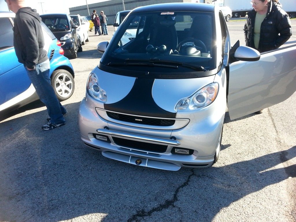

If you have a scan gauge or a ODBII scanner that will show live data streams from the CAN BUS you can check to see how far your throttle body is opening. I learned that from JetFuel riding about 160 mph down the interstate in his turbo Brabus. Golly what a difference a turbo makes. I am so in love with his car. His mods are awesome and well executed.DCO
